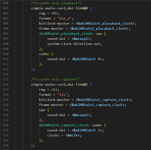

Hi expert,
Customer is using SDK9.0 and custom board
They need to modify the clock for the McASP. We can change the register to the desired frequency but don't know how to integrate it to the code. Could you please help to check where we need to change? Thanks
