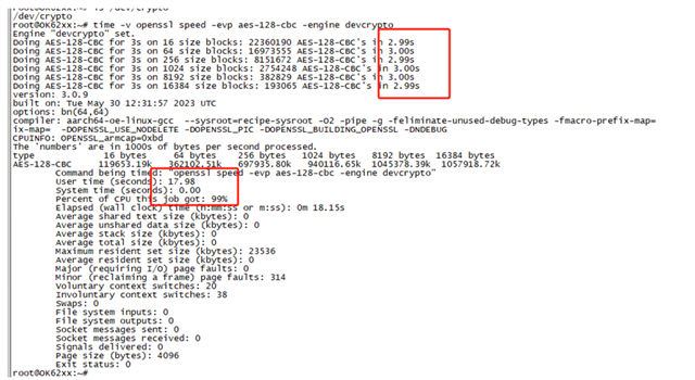

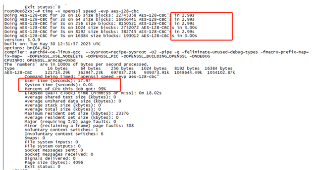

We used the SDK 10 patch to enable  crypto hardware accelerator, it works well on SDK10, but after backport to SDK9.0, it doesn't work. Test steps:
1, Merged new patch on SDK9.0,
2, Updated SDK9.0 sa2ul.c with SDK 10.00.07.04 sa2ul.c
The test result is same as before: the crypto hardware accelerator process time is same as w/o hardware accelerator processing time, please see below logs for details
With accelerator enable
Software to do crypto ways

  • Verify that dmesg logs doesn't have any failure logs regarding sa2ul
    Looks like sa2ul algorithms failed to register
    check cat /proc/crypto and see SHA512, sha256 and AES are getting registered with sa2ul
    As Praneeth suggested, port the minor changes manually for base file after copying
  • Yes, only two files have been modified.The drivers/crypto/sa2ul.c and drivers/crypto/sa2ul.h before and after the modification as follows.
    before modify sa2ul.cbefore modify sa2ul.h
    after modify sa2ul.cafter modify sa2ul.h
  • root@OK62xx:/# dmesg | grep sa2ul
    There were no search results.The result cat /proc/crypto as follow.
    root@OK62xx:/# cat /proc/crypto

  • Hi, I've tested the patch out to enable AES, AEAD and SHA-256 algoritms on 9.0 and 10.0 SDK using kernel self tests and openssl
    Base commit: c1c2f1971fbf6ddad93a8c94314fe8221e7aa6be
    Tag: 09.03.01
    Please apply the 6 patches that have been shared previously (also attached here) and then this 0007-crypto-sa2ul-enable-other-algos.patch
    Previously shared patches:
    0001 0002 0003 0004 0005 0006
  • Thank you.The problem has been solved.
