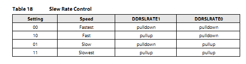

  • Hi Bill,
    Not sure you've got the order right.  I remembered that the bit order from Fastest to Slowest was counter-intuitive.
    The H/W design guide has:
    Unless the h/w design guide is wrong of course.
    Richard.
  • Hi Richard,
    The table in the Hardware Design Guide is incorrect.  It should be as follows.
    With Regards, Bill
    Table 18           Slew Rate Control
    Setting
    Speed
    DDRSLRATE1
    DDRSLRATE0
    00
    Fastest
    pulldown
    pulldown
    01
    Fast
    pulldown
    pullup
    10
    Slow
    pullup
    pulldown
    11
    Slowest
    pullup
    pullup
