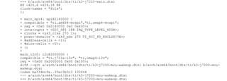

    I see in the referenced appnote that the spi node needs a clock defined:
    I did not see that in the snippet of device tree sent, but is the clock defined?
    Takuma
  • Hi Takuma
    Basically, clock is defined in k3-j7200-main.dtsi like below.
    main_spi6: spi@2160000 {
    compatible = "ti,am654-mcspi","ti,omap4-mcspi";
    reg = <0x00 0x02160000 0x00 0x400>;
    interrupts = <GIC_SPI 190 IRQ_TYPE_LEVEL_HIGH>;
    #address-cells = <1>;
    #size-cells = <0>;
    power-domains = <&k3_pds 272 TI_SCI_PD_EXCLUSIVE>;
    clocks = <&k3_clks 272 1>;
    status = "disabled";
    and I added below code based on it.
    +&main_spi6 {
    + pinctrl-names = "default";
    + pinctrl-0 = <&spi6_pins_default>;
    + status="okay";
    + spidev@0 {
    + spi-max-frequency = <24000000>;
    + reg = <0>;
    + compatible = "linux,spidev";
    BR
    Jace

  • Hi Jace,
    I reviewed our device tree and it looks like the clock has the wrong clock ID.
    https://e2e.ti.com/cfs-file/__key/communityserver-discussions-components-files/791/0001_2D00_Change_2D00_clock_2D00_ID_2D00_for_2D00_main_2D00_SPI6.patch
    Could you change the ID from 1 to 4 like above patch?
    I think what happened was the clock ID from J721E was used instead of J7200: https://software-dl.ti.com/tisci/esd/latest/5_soc_doc/j7200/clocks.html#clocks-for-mcspi6-device
    Takuma
  • Hi Takuma
    I changed k3-j7200-main.dtsi as you suggested, but the crash still happen at the same point.
    diff --git a/arch/arm64/boot/dts/ti/k3-j7200-main.dtsi b/arch/arm64/boot/dts/ti/k3-j7200-main.dtsi
    index 16ff103cf..cdd5803da 100644
    --- a/arch/arm64/boot/dts/ti/k3-j7200-main.dtsi
    +++ b/arch/arm64/boot/dts/ti/k3-j7200-main.dtsi
    @@ -1223,7 +1223,7 @@ main_spi6: spi@2160000 {
    #size-cells = <0>;
    - clocks = <&k3_clks 272 1>;
    + clocks = <&k3_clks 272 4>;
    [ 5.016509] Call trace:
    [ 5.018943] clk_get_rate+0x20/0x80
    [ 5.022417] omap2_mcspi_probe+0x3a4/0x57c [spi_omap2_mcspi]
    BR
    Jace

            { .compatible = "menlo,m53cpld", .data = &spidev_of_check },
            { .compatible = "cisco,spi-petra", .data = &spidev_of_check },
            { .compatible = "micron,spi-authenta", .data = &spidev_of_check },
    +       { .compatible = "linux,spidev", .data = &spidev_of_check },
     MODULE_DEVICE_TABLE(of, spidev_dt_ids);
    BR
    Jace
  • Hi Jace,
    I reviewed and also applied your patch on top of default 9.2 SDK and was not able to reproduce your error message:
    https://e2e.ti.com/cfs-file/__key/communityserver-discussions-components-files/791/0001_2D00_Enable_2D00_main_5F00_spi6_2D00_for_2D00_J7200_2D00_9.2_2D00_SDK.patch
    Below are the logs that I see:

    Just to confirm, are there any other modifications to the SDK or the EVM board?
    Takuma
  • Hi Takuma
    After clean build with the last patch, it works correctly.
    Thank you for your supprt !!
    BR
    Jace
