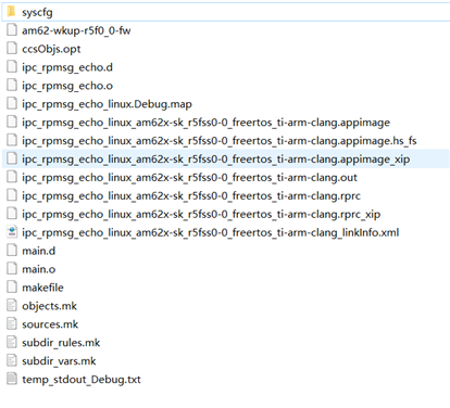

When I compile the uboot source code of am62, I want to modify /ipc_echo_testb_mcu1_0_release_strip.xer5f in the following command to the project file compiled by myself. However, after I use ccs to build the example in mcu, I can't find the xer5f file in the generated debug folder. How can I generate the xer5 file through ccs?Can I use the am62-wkup-r5f0_0-fw file directly in make DM=?
    The *.xer5f and the *.out file are exactly same. The xer5f is a custom extension for .out file which tells it is an executable for r5f core.
    The am62-wkup-r5f0_0-fw is the strip version of *.out
    Follow the steps mentioned here to change the R5F firmware binary.
