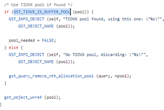

We want to develop our own plugins to implement the application of some simple algorithms.
The specific process is as follows:
1.According to official information from gstreamer(gitlab.freedesktop.org/.../lv2),built a self-developed plugin.
2.Then apply the plugin to the normal pipeline;
3.An error occurred.Please refer to the attachment for details;

ERROR: from element /GstPipeline:pipeline0/GstV4l2Src:v4l2src0: No downstream pool to import from.
Additional debug info:
../gst-plugins-good-1.20.7/sys/v4l2/gstv4l2object.c(5305): gst_v4l2_object_decide_allocation (): /GstPipeline:pipeline0/GstV4l2Src:v4l2src0:
When importing DMABUF or USERPTR, we need a pool to import from

4.When we set io-mode to 2 and 4, it can run normally, but there will be frame drops.
May I ask if there are any other solutions for me to apply my self-developed plugin before the tivoxisp plugin when io mode=5.
