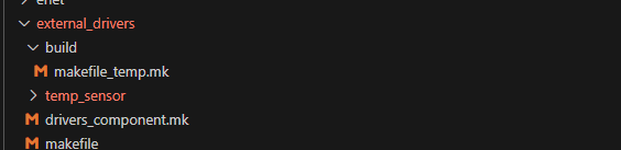

Hi @TI-Engineer,
I have the ti-processor-sdk-rtos-j721e-evm-09_02_00_05 installed in my system.

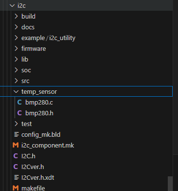

I have the source of the driver and I have created inside the /drv/i2c folder
Inorder to use the functions/APIs inside the temp_sensor folder, I have added the necessary includes and corresponding makefile changes in the application code that I need to run.

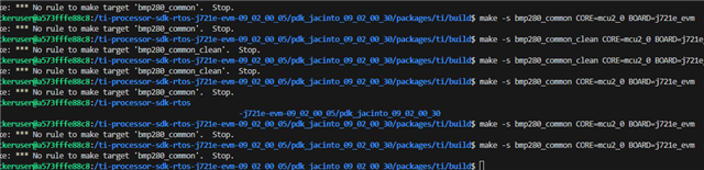

I'm able to successfully build the application - "make -s CORE=mcu2_0 BOARD=j721e_evm drv_i2c_utility".
But to improvise this, I wanted to generate a library file for the temp_sensor folder and add the generated library file to whichever makefile of whichever application I wanted to run.
How to generate external libraries into the ti-sdk and run the application which uses the APIs of these libraries?

  • Hi Niranjana,
    1.Need to create Makefile in temp_sensor folder
    2.Include make file of I2C  library in i2c_component.mk
    Please refer the attached file

  • Thanks @Karthikeyan,
    I have created a new folder,
    How do I add this folder to the sdk?
    I have added the changes in the comp_path.mk as well..
    But when I compiled the module , it's not recognising.
    "bmp280_common" is the component I wanted to integrate. I have create corresponding makefiles and component files.
    What should I do so that the above module gets compiled?

  • Hi Niranjana,
    Please refer this eeprom example for adding your  folder to the sdk   /pdk_jacinto_09_02_00_30/packages/ti/drv/i2c/test/eeprom_read, need to create one makefile inside the folder  and temp_sensor update required in i2c_component.mk file.
    Please refer the attached example folder.
    sensor.zip
    i2c_component.zip
    Karthik
  • Thanks Karthik,
    I was able to resolve the issue after adding those paths inside ti/build..
