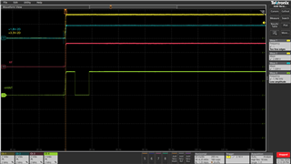

I am having a problem where the system does not switch to HPI boot mode.
This is occurring in 1 out of 80 units.
I monitored DVDD +3.3V CVDD +1.8V 51-pin HINT 27-pin XF 66-pin INT2.
Why does 27-pin XF go Low?
XF remained Hi on the good unit. Why does 51-pin HINT go Hi→Low→Hi?
Any ideas?
Waveform of the defective unit
Waveform of the good unit

  • Hi Maruyana,
    Apologies for the delayed response.  Can you provide some additional details:
    • You mention 1 out of 80 devices fail.  Is this out of 80 total units, or is the 1.25% failure rate extend across a larger quantity of units, and if so, how many total?
    • Is this using a TI designed board, or is this a custom board that you have designed?
    • Have you tried doing an A-B-A swap, of putting a known good device on this board that is failing and putting this failing device on a known good board to see if the problem tracks to the device or the board?
