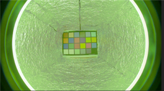

    I have also tried the following configuration, but the result is the same yellow-green color as the above picture. I would like to ask you to help me tell me why the image becomes like this and what solutions are available. Thank you.
  • Hi Jiarong,
    I am not sure if the green color is in your input raw image because of white balance.

    The YUV image in auto.zip looks OK to me.
    It is much better than the greenish picture you shared above.
    White balance is not accurate and it could be a AWB calibration issue.
    You may calibrate AWB to see if white balance can work properly.

    The WDR tab shows that you are decompanding your raw image in ISP with a set of knee points.
    If those knee points does not match your sensor raw image, then color will be distorted.
    Please follow the plugin guide for more details.
  • CFA_WDR.zip
    Your raw image looks like in WDR companded format.
    You would need to check your sensor driver to see what are the correct WDR companding knee points.
    With wrong knee points, color will be wrong typically on bright things in the view.
    Dark part in the view may be OK, because the first section of companding is always linear.

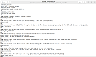

    I set WDR in the python script.
    Do you mean that knee points should be found from the sensor driver?
    But when I bring up the camera, I use TI's sample code :single_cam. Are the companding knee points in the driver the same as those preset by TI?
  • But when I bring up the camera, I use TI's sample code :single_cam. Are the companding knee points in the driver the same as those preset by TI?
    If you used the TI sensor driver for IMX390, then those knee points should be correct.
    The single-cam app does not specify which sensor driver you use.
    In tuning tool, you would need to input those correct knee points.

  • So does it mean that the knee points I set are correct?
    Correct with python script, but wrong with tuning tool.
    But you mentioned that the single-cam app doesn't specify the sensor driver I'm using, and I don't understand what that means.
    When you said that you used the single-cam app, I cannot tell which sensor driver you use.
    I should have entered the correct inflection point because I always use the default value.
    In tuning tool, you need to enter the correct knee points.

  • but I did not see the details of Knee points.
    There is no details about the knee points.
    You just would need to enter them correctly.
    You already have used those knee points in your python script configuration file.
    You just need to enter those values into the WDR tab.
    Where do I get the correct inflection point provided by TI?
    They are included in the sensor register values programmed by the sensor driver.
  • Hi, thank you for your reply.
    I understand what you said, I need to put my 6 sets of knee points into the dcc tool.
    I put knee points here.
    But it can be seen from the content that the maximum value of X is only 4095, so my Knee_X:65535 cannot be filled in the DCC tool. Will this have any impact?
    And because each THR X value must be larger than the previous THR X value.
    There are only 5 knee points left that I can input. I would like to know how to input them better?
    I currently know that these 5 values ​​need to be filled in, and if values ​​of similar distance are inserted into these 5 intervals respectively, so that the total number becomes 14, this will also cause the problem of the image color turning yellow-green.
    But if I fill in 0,512,1408,2176, and then start from 4000 and add 10 to each grid until 4095, the image color will not appear to be affected.
  • Hi Jiarong,
    That is ok.
    You may input some extra one at the first section.
    e.g., from
    0   0
    512 512
    to
    0 0
    1 1
    2 2
    3 3
    4 4
    512 512
    Alternatively, you may keep the xml and LUT files for decompanding from the python script if you are not making any changes.
