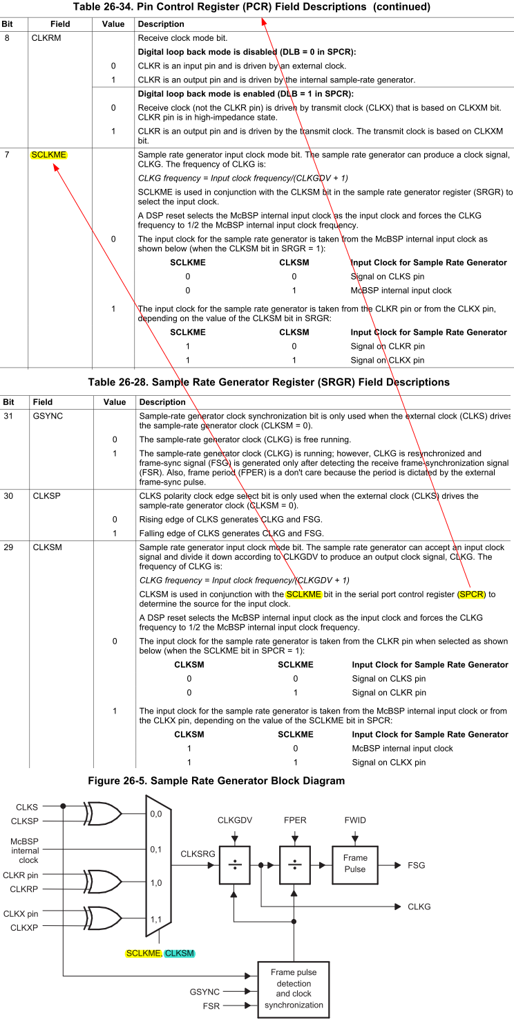

I would like to ask a question on OMAPL138 McBSP.
In OMAP-L138 C6-Integra DSP+ARM Processor Technical Reference Manual, SPRUH77, register bit SCLKMT is one of the two registers (the other being CLKSM) to select clock source of Sample Rate Generator. However, although SCLKMT is actually found in as PCR[7], in Table 26-28 it is said to be a bit of SPCR, and SPCR register description doesn't actually contain this bit.
So I simply believe it must be a typo. Is it correct?
