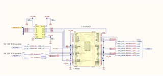

Hi All,
I'm trying to turn on PCIE in AM6442 as a RC. but I'm getting the following error while booting. Is there anything I need to change in device tree? Or is this a normal behavior of driver?
