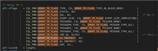

regarding TRM of J84S4, chapter 10.1.2.3.4.8, DRU supports indirect addressing for source and destination address (ISA and IDA).
I tried to use this feature but it seems that only direct addresses are supported. Setting IDA, ISA has no effect.
Are there any other restrictions which are not mentioned inside the TRM?
Is there any example available somewhere which is demonstrating this feature? I found nothing inside Processor-SDK.
best regrads,
Alex

  • Hi Takuma,
    I´m sorry for not being presize enough, I`ve found a lot of DMA examples inside pdk and app_utls, and as I see, all of them using direct addressing (UDMA_TR_FLAGS_SA_INDIRECT = 0)..
    But I would like to ask for examples or more explanation about indirect addressing (UDMA_TR_FLAGS_DA_INDIRECT  or UDMA_TR_FLAGS_SA_INDIRECT = 1).
    Alex

  • Hi Takuma,
    I have to move 3-dimensional data-blocks with regular constant shape, but non-regular source-/ destination address from DDR into L2 and back.
    Currently I´m doing this using API from app_utils,  appUdmaCopyNDInit(), appUdmaCopyNDTrigger() a.s.o. for each block.
    I observed that appUdmaCopyNDInit() is consuming a non-neglectable amount of cycles, so I´m searching for a faster solution.
    My idea is to keep the DRU channel config static, just modifing the address and re-trigger the channel. Is this possible?
    If yes, which kind of address are expected? Physical or virtual? Are the any restrictions of the indirect addresses?
    Alex
