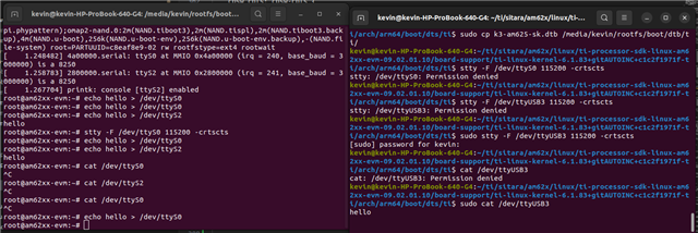

Customer is working on AM62x SDK9.2 SK-AM62 board.
They want to use MCU_UART0 in Linux and follow the following guide to add the pinmux and make the "status" to okay.
https://e2e.ti.com/support/processors-group/processors/f/processors-forum/1355684/processor-sdk-am62x-how-mcu-domain-periphals-working-in-linux?tisearch=e2e-sitesearch&keymatch=linux%252525252525252520mcu_uart0#
They added the following to k3-am625-sk.dts
&mcu_pmx0 {
	mcu_uart0_pins_default: mcu_uart0_pins_default {
		pinctrl-single,pins = <
			/*AM62X_IOPAD(0x014, PIN_INPUT,0)/* (B5) MCU_UART0_RXD */
			/*AM62X_IOPAD(0x018, PIN_OUTPUT,0)/* (A5) MCU_UART0_TXD */
			/*AM62X_IOPAD(0x01c, PIN_INPUT,0) /*(A6) MCU_UART0_CTS */
			/*AM62X_IOPAD(0x020, PIN_OUTPUT,0) /*(B6) MCU_UART0_RTS */
			/*AM62X_MCU_IOPAD(0x001c, PIN_INPUT, 0) /* (A6) MCU_UART0_CTS */
			/*AM62X_MCU_IOPAD(0x0020, PIN_OUTPUT, 0) /* (B6) MCU_UART0_RTS */
			AM62X_MCU_IOPAD(0x0014, PIN_INPUT, 0) /* (B5) MCU_UART0_RXD */
			AM62X_MCU_IOPAD(0x0018, PIN_OUTPUT, 0) /* (A5) MCU_UART0_TXD */
&mcu_uart0 {
	status = "okay";
	pinctrl-names = "default";
	pinctrl-0 = <&mcu_uart0_pins_default>;
The full k3-am625-sk.dts file is below.
https://e2e.ti.com/cfs-file/__key/communityserver-discussions-components-files/791/5047.k3_2D00_am625_2D00_sk.dts
We think after these changes, the MCU_UART0 should work in Linux. However, after customer loaded dev/ttyS0 to the MCU_UART0, there is nothing print come out in the command:   echo ttyS0
So based on this result, we think the MCU_UART0 is still not configured properly to be used in Linux. Could you please provide some feedback to help us?
Kevin

    [    0.287152] 4a00000.serial: ttyS0 at MMIO 0x4a00000 (irq = 240, base_baud = 3000000) is a 8250
    [    0.288474] 2800000.serial: ttyS2 at MMIO 0x2800000 (irq = 241, base_baud = 3000000) is a 8250
    [    1.665323] printk: console [ttyS2] enabled

    root@am62xx-evm:~# dmesg |grep serira  al
    [  117.687208] systemd[1]: Created slice Slice /system/serial-getty.
    root@am62xx-evm:~# [  162.017870] kauditd_printk_skb: 5 callbacks suppressed
    [  162.017900] audit: type=1701 audit(194.368:33): auid=4294967295 uid=0 gid=0 ses=4294967295 pid=327 comm="ti-apps-launche" exe="/usr/bin/ti-apps-launcher" sig=11 res=1
    [  162.117973] audit: type=1334 audit(194.468:34): prog-id=21 op=LOAD
    [  162.124407] audit: type=1334 audit(194.472:35): prog-id=22 op=LOAD
    root@am62xx-evm:~#

    root@am62xx-evm:~# echo ""
    root@am62xx-evm:~# echi   o ::  ""1"2"3"4"5"6"0" """ > /dev/ttyS0
    ^C
    root@am62xx-evm:~# cat /dev/ttyS0
    ^C
    root@am62xx-evm:~#

    Customer also finds the following information coming out from the mcu_uart0
    Customer also tried configure the dts the same as k3-am62x-sk-lpm-wkup-sources.dtso , but the result is the same.
    Customer also tried your suggestion in the above thread, using the base image instead of the default one, but still the same result. The boot image in the "tisdk-base-image-am62xx-evm.wic.xzbase image customer used is Image-6.1.83-ti-gc1c2f1971fbf
    The exact command customer used is quite simple. Firstly they configured the corresponding baud rate using  stty -F /dev/ttyS0 115200 cs8 -cstopb -parenb
    Then customer used   echo "xxx" > /dev/ttyS0    but as you could see from the log, there is noting came out, the situation is very similar to the above thread.
    Could you please let us know what else might be needed to try further?

    Then I recompiled k3-am625-sk.dtb, and replaced that in the base image.
    Then I use SD card boot the EVM board, and follow the below 4 steps.
    1: After EVM board boots up, run stty -F /dev/ttyS0 115200 -crtscts
    2: On the PC run sudo stty -F /dev/ttyUSB3 115200 -crtscts
    3: On the PC run sudo cat /dev/ttyUSB3
    4: On the EVM board run echo hello > /dev/ttyS0
    Then I got the below result which is passed.
