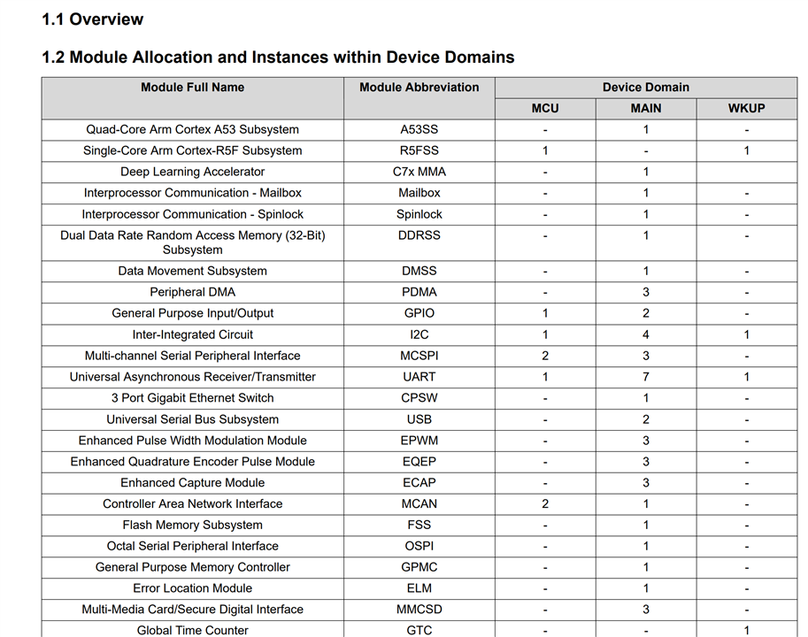

    * Can the MCU R5 of AM62Ax access the Packet DMA? or is only A53 accessible?
    * Similarly, CPSW could run either from MCU R5 or A53?
    * As seen in the images below, we suspect missing documentation in AM62Ax and specifically the highlighted registers are needed to continue coding.

  • The networking link you sent contains a similar example to the one that we used.
    Our concern is about the TRM, which is missing register documentation, pls see below the comparison in TRM documentation, AM62Ax vs AM62Px, clearly the AM62Ax is missing a lot of detail that we need to make the ethernet DMA working.
    Thank you

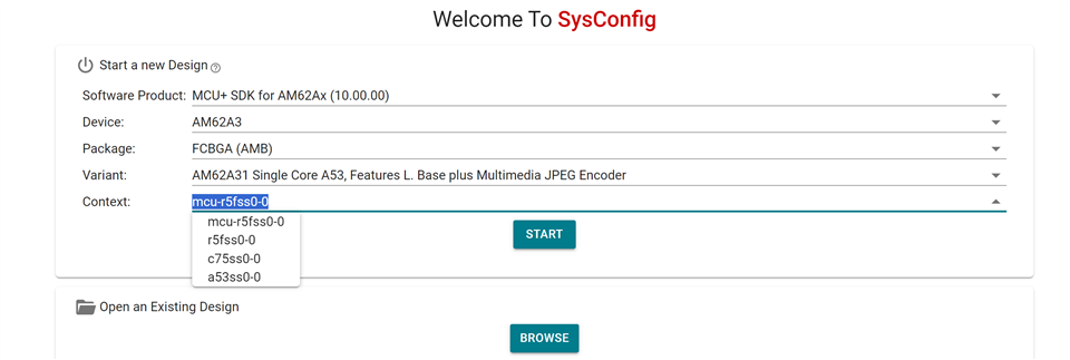

    A quick answer will be to check in AM62A-TRM and SysConfig (ti.com)
    If you need further help on specific peripheral, please raise as separate request.
    I will assign that to the domain expert to help you better.
