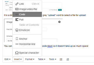

    Looking for how to attach (upload) our custommachine.dts into this E2E forum.
  • I cannot find a way to upload a file. Is there one?
    Copying the whole DTS here. Loosing the indentation though :(.

    Yes, you can upload a file like this:
    It is a bit tricky, you have to click on the grey "upload" word to select a file for upload:
    You can also put terminal output in the code block so it doesn't take up as much space:
    Nick
