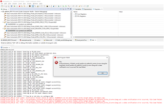

I'm trying to create a first simple 'Hello World' application (using CCS) build it and run it on the SK-AM62 evaluation board. I would like to understand from you how I should do this because I have tried in various ways and did not manage to do this... I would like to get some clear answers from your side.
 Where I have used as I have indicated in the previous post the MCU-PLUS-SDK-AM62X "mcu_plus_sdk_am62x_08_06_00_18-windows-x64-installer.exe". This SDK has some "hello world" examples inside and I think the ones that I have tried to build are created for the M4F, if my understanding is correct.
After setting according to this statement, a new error occurred.
BLAZAR_Cortex_M4F_0: Can't Run Target CPU: (Error -1268 @ 0x1090001) Device is locked up in Hard Fault or in NMI. Reset the device, and retry the operation. If error persists, confirm configuration, power-cycle the board, and/or try more reliable JTAG settings (e.g. lower TCLK). (Emulation package 12.8.0.00189)
As you can see, the program failed to join.
Waiting for your team to provide other suggestions.
thank you!

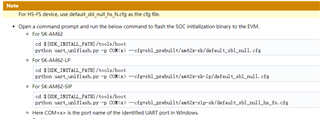

    Thanks for reaching out to Texas Instruments E2E support forum.

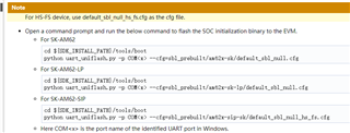

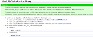

    Can you please confirm have you initialized the SOC before running the program?
    To initialize the SOC using SBL binaries, please refer EVM_FLASH_SOC_INIT for more details.
    Can you please also tell us the reason behind using an older SDK? As the newer version of SDK is already available on MCU-PLUS-SDK-AM62X

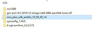

    You are using CCS v12.8 but the SDK makefile is configured for CCS v12.7.0.
    Can you please update the CCS path to ccs1280 in imports.mak file located at root directory of MCU+SDK.
    Tushar
    We are currently using this SDK.
    I can see that you are using SDK v10.0 which is the latest one. Thanks for sharing the screenshot above.
    Tushar
    Updating the CCS path in the imports.mak file in the MCU+SDK root directory to ccs1280 still fails.

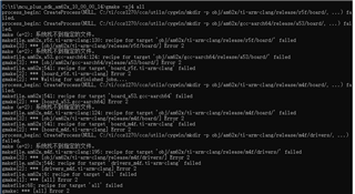

    Now the error message got change. Error coming is not related to CCS anymore.
    Can you please tell us what command are you running and from which directory it is run?
    Tushar
    This is the command executed in the directory where I am located, and the result of executing the command.
    I have tried to build the SDK using above command gmake -sj4 all and it is working fine for me.

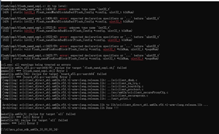

    Can you please tell have you modified the SDK code?
    I can see you are getting error related to flash_nand_ospi.c file. Can you please share the flash_ospi_nand.c file with us?
    Tushar
    I did not modify the SDK code. It is downloaded from the official website and decompressed for use.
    mcu_plus_sdk_am62x_10_00_00_14.zip
    I am sharing the flash_ospi_nand.c file code below, Please compare the code with the file present in MCU+SDK.

    Can you also try building the SDK once, after including the stdint.h header file in flash_ospi_nand.c file? Add the below line of code to the top of flash_ospi_nand.c file and try to build the SDK again.
    #include <stdint.h>
    Tushar
    I compared and found that the two files are exactly the same, with added header files, but it still doesn't work. Can you try using the SDK package I gave you?
    I have checked building with above zip package also and it is working fine for me.
    Tushar
    I deleted everything under "C: \ ti" and reinstalled it. CCS installed ccs1270, and now "gmake - sj4 all" has succeeded, but the subsequent operations have failed.
    The above command you are trying to run is incorrect. Please run below command.
    python uart_uniflash.py -p COM5 --cfg=sbl_prebuilt/am62x-sk/default_sbl_null.cfg
    Tushar
    My problem has been resolved。
    There are two errors:
    1、
    I copied 'gcc-arm-9.2-2019.12-mengw-w64-i686-arch64-none elf' to 'C: \ ti', which is incorrect. I can only decompress it directly and cannot copy it.
    Otherwise, there will be a bunch of "gmake" errors.
    There is a question here, why can't it be done through copying?
    2、
    Command error, not com<5>, it is com5.
