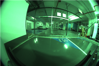

TDA4VH-Q1: VPAC Demosaic & Undistort Output Differs in Contrast and Sharpness Compared to CPU – Parameter Adjustments
I'm working with the **SVC220 sensor** on the **TDA4 VPAC ISP**, and I noticed that the output from the VPAC differs from my CPU implementation, particularly in contrast and sharpness.
I'm using the VPAC to perform demosaicing and undistortion on raw images. When I compare the results from the VPAC with my CPU implementation, the VPAC output has better contrast and appears sharper. These differences may affect the performance of the neural network, which processes the output images. My concern is that the differences between the VPAC and CPU outputs could impact the consistency of the neural network's results.
Here's the code snippet I'm using for the CPU demosaicing:
```cpp
cv::demosaicing(convImg16.getCpuConst(), demosaicImg16.getCpu(), cv::COLOR_BayerRG2BGR, 3);
**SVC220 Sensor Properties**:
```plaintext
SENSOR_ID 250
PRJ_DIR ../svc_output
SENSOR_NAME svc220
SENSOR_DCC_NAME svc220
SENSOR_WIDTH 1920
SENSOR_HEIGHT 1280
# 0=RGGB; 1=GRBG; 2=GBRG; 3=BGGR, 4=MONO
COLOR_PATTERN 3
# Sensor mode: 0 for linear (no decompanding), 1 for WDR (decompanding)
WDR_MODE 0
# Raw sensor image BIT_DEPTH: 8, 10, or 12 for linear sensors; typically 12 for WDR mode
BIT_DEPTH 12
# WDR BIT_DEPTH: Bit depth after decompanding, typically 20 or 24
WDR_BIT_DEPTH 16
# WDR decompanding knee points (comma-separated without spaces)
WDR_KNEE_X 0,512,837,1162,1487,1812,2137,2462,2787,3112,3437,3762,4087,65535
WDR_KNEE_Y 0,512,1024,2048,4096,8192,16384,32768,65536,131072,262144,524288,1048575,1048575
# Sensor black level to subtract before decompanding (for linear sensors only and some Sony WDR sensors)
BLACK_PRE 0
# Sensor black level to subtract after decompanding (for most WDR sensors and all linear sensors)
BLACK_POST 168
# GAMMA value for compressing 20/24-bit WDR raw to 16-bit ISP internal
# Typically around 50 (0.5) for 24-bit WDR sensors and 70 (0.7) for 20-bit sensors
GAMMA_PRE 50
# LSB location for H3A input bit range (from bit-H3A_INPUT_LSB to bit-H3A_INPUT_LSB+9)
H3A_INPUT_LSB 2
**My Question**:
Is there a way to adjust the runtime parameters of the VPAC (such as contrast or sharpness) to make the output closer to that of the CPU? Ideally, I'd like to achieve consistent output between the VPAC and CPU versions to minimize the impact on the neural network's results.
Any suggestions on where I might tune parameters or settings (perhaps related to gamma or black level) would be greatly appreciated!
Thanks in advance for your help!

    1. Black Level and Gains: I see that the current black level being used in OpenCV is set to 167.5744f, with the following gain values for each channel:
      • Red Gain: 1.05
      • Green Gain: 0.56
      • Blue Gain: 0.966
      Should I directly set these values in the Python script’s configuration file for the linear raw sensor images? If so, could you point me to the exact location in the script or configuration file where these should be applied?
    2. Potential Issue with NV12 Output: I realized we are using the NV12 output format in the VPAC VISS and then converting it to RGB during the saving process. Since the Edge Enhancer module works only on the Luma (Y) channel, I suspect that the enhancement is being applied before the NV12 to RGB conversion, which might be the cause of the difference in sharpness and contrast compared to the CPU output. Does this seem like a plausible reason for the discrepancy? If so, would there be a way to adjust or disable the edge enhancement in the VPAC pipeline?
    Aviad
  • I see that the current black level being used in OpenCV is set to 167.5744f,
    Using 168 in python script should be fine.
    • Red Gain: 1.05
    • Green Gain: 0.56
    • Blue Gain: 0.966
    This looks like for AWB gains, but it is weird that the value may be less than 1.0.
    You may bypass EE by settings ee_mode of the tiovx kernel to 0.
    https://software-dl.ti.com/jacinto7/esd/processor-sdk-rtos-jacinto7/latest/exports/docs/tiovx/docs/user_guide/structtivx__vpac__viss__fcp__params__t.html#a41ed424767032aa77af0ed523e708a96
  • Hi Gang,
    Thank you for the detailed response!
    1. Black Level: I’ll use a value of 168 for the black level in the Python script as suggested.
    2. AWB Gain Values: You mentioned that the values I’m using for Red, Green, and Blue gains (1.05, 0.56, 0.966) seem unusual, especially for values less than 1.0. These were extracted from OpenCV processing, and I would like to discuss this further to understand the implications of using these in the VPAC. Could this affect how the RGB values are being interpreted in the VISS pipeline?
    3. Edge Enhancement: Since the Edge Enhancer (ee_mode) was already set to 0, I assume the differences I’m seeing are not due to edge enhancement. I’ll continue testing with this configuration.

  • hi Gang,
    here are the images.
    the original pgm file:
    the output with the new params.
  • i cannot upload the PGM file.
  • Hi Aviad,

  • Hi Gang,
    We've encountered a new issue regarding the edges of the image, which seems to be related to the undistortion process.
    I also wanted to clarify that while we know the sensor is in the BGGR pattern, I thought we were fully aligned on that detail.
    I mistakenly flipped RGB to BGR before saving the images, which caused some confusion.
    I've corrected this mistake now, and attached are the updated raw images and outputs from TDA and PC, as well as the outputs of the DCC defaults generated for BGGR.
    Let me know your thoughts, and if you have any suggestions for handling the edge artifacts we're seeing.
    latest.zipAviad
  • Hi Aviad,
    These are the correct xml files for RGGB or BGGR.
    They should work properly without the brightness issue.
    While I copied the filter sections above, I copied the wrong one without some needed "{" and "}".

  • Hi Gang,
    I've tried to apply the gamma using the DCC tool. I created a LUT, inserted it into the DCC tool, added the GAMMA LUT XML to the generate DCC script, and included it in the VISS header file. However, it had no effect on the output.
    I've looked through the code, and it seems we're unable to change anything in the CC in Flexible CFAI. I manually changed the black levels in the BLC XLS file, and this had the most significant effect on the image.
