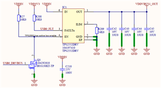

My device tree has following additions for the USB (for now I focus on USB2.0) :
+       main_usb0_pins_default: main-usb0-default-pins {
+               bootph-all;
+               pinctrl-single,pins = <
+                       AM64X_IOPAD(0x02a8, PIN_OUTPUT, 0) /* (E19) USB0_DRVVBUS */
        ospi0_pins_default: ospi0-default-pins {
                        AM64X_IOPAD(0x0000, PIN_OUTPUT, 0) /* (N20) OSPI0_CLK */
@@ -350,6 +357,20 @@
        disable-wp;
+&usbss0 {
+       bootph-all;
+       u-boot,dm-spl;
+&usb0 {
+       bootph-all;
+       dr_mode = "host";
+       u-boot,dm-spl;
+       maximum-speed = "high-speed";
+       pinctrl-names = "default";
+       pinctrl-0 = <&main_usb0_pins_default>;
Any help is appreciated!

  • I just noticed that the USB power switch we are using is different from the one in the SK devkit. We are using TPS2552DRV (Enable input, logic low turns on power switch) while SK kit uses TPS2051CDBVR (Enable input, logic high turns on power switch).
    So the required polarity for USB power switch enable line (AM64 pin E19, signal USB0_DRVVBUS) is different for my custom board... So quite likely this will be the cause of the crash I'm seeing.
    Is there a way to change via DTB?
    If not, is there a way to change via patch in the Cadence CDNS3 driver code?
    thanks for the help,
    Marc
  • I need to recall my last message, since I overlooked that we invert the USB0_DRVVBUS signal to cope with the different polarity of the USB switch... I'm adding here the section of the schematic with the enable signal inverter and the power switch.
    So this would *not* be the cause of the crash..

    Even if you didn't revert the DRVVBUS signal, I don't think it is the cause. The DRVVBUS signal is to enable VBUS power for the attached USB device, it shouldn't have anything to do with the USB controller.
    I am going to review your update of the debug information in a couple hours.
