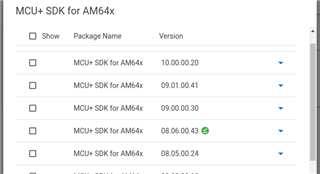

  • Hi Ashwani,
        Thanks for your reply.
        I could not find the version of SDK8.6.0.45 from CCS.
        Actually, I am finding a demo of ICSSG0 on AM6442, any other SDK version will be OK. Maybe you can help me solve another problem about ICSSG0.
