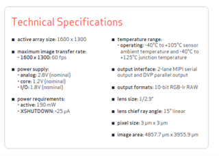

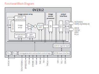

  • Hello Aditya,
    Since the AM625 doesn't have an ISP, why do you use OV5647? I would recommend you to use OV5640 and avoid all those conversions.
    Jianzhong
    I know this, but in my hardware we've connected OV5647 and there is not an other option for it, the only 2 options are OV5647 or OV2740, so I've to achieve this on both.
    Also, in my end application I've to stream the camera output on browser, like use camera for google meet.
    So, if there's any way to stream the camera data on display while capturing it would help me.

  • It is not recommended to use a sensor without ISP on AM62x. Using the CPU to do raw image processing would not give you good performance or good image quality.
  • Well, I know that. But, then also we have decided to use it.
    So if you can help me with live streaming the data through internet like using google meet, it would help me a alot.
    Aditya T

    Could you let me know whether OV2312 will work with AM625?
    Below is block diagram and product specs for OV2312
    Aditya T
  • The OV2312 has RGB-Ir RAW output which also requires an ISP. Therefore it won't work with AM625, but this sensor is supported on AM62A.
    What is your application? Does it require color images? If not, you can use some monochrome sensor which doesn't require an ISP.
