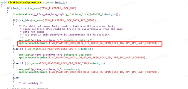

  • I have confirmed the communication between A72 and R5f are using spinlock in TIOVX, and it seems the side of A72 has not disabled all interrupts before acquire spin lock. Is it possible that scheduling of A72 occurs while A72 is holding the spin lock and  cannot release the spin lock in time, in which period R5f is just spinning, no any scheduling?
    Please see the picture below(a internal abstracted spin lock interface for all cores,  SDK8.2). Interrupts is not disabled.  I may misunderstand something as I could not understand TIOVX well.
  • Hi Frank,
    Yes, that's possible. but do you have other high priority tasks running on A72 Linux?
    Btw, its not possible to disable interrupts from user application on Linux.
