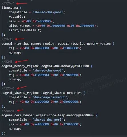

However, there are still some default memory allocation which are not explained in the above guide, customer has summarized in the following picture.
So basically there are 5 memory allocation customer do not understand their usage/function.
linux, cma
edgeai_rtos_ipc_memory_region
edgeai_memory_region
edgeai_shared_region
edgeai_core_heaps
Customer may need your help to know the exact meaning of the above 5 memory allocation, so that they could better understand if they could skip or need to keep them.

  • Hi Kevin,
    These regions are critical and cannot be skipped if they wish to use Edge AI features for vision or imaging (ISP, deep learning).
    If these are modified, please do this from the vision_apps/platform/am62a/rtos/gen_linker_mem_map.py script within the Firmware Builder. It will ensure that DTS, linker scripts, and a few headers are kept in sync. This requires the AM62A Firmware Builder (available from SDK page, requires the user request access). Instructions on updating the memory map are in the firmware-builder User's Guide
    linux, cma
    • Linux continuous memory allocation. Linux will use this as a DDR region. It must exist, but can be made smaller
    • Used for inter-processor communication, mostly for TIOVX (a critical middleware that facilitates application running across accelerators on the device). Should be left as is -- 16 MB is the minimum size
    • Used for DMA in edgeai applications. Should also be left as is
    • A region of DDR set aside for intermediate frames that will be shared between cores. This can be reduced, but will impact how large of buffer pools can be used (relative to
    edgeai_core_heaps
    • This is an aggregate size of multiple different heaps that are allocated to accelerator cores, nominally the R5F that manages VPAC (HWA with ISP, scaler enginer, lens distortion) and the C7xMMA (AI accelerator)
    • This can be reduced in size.
    These regions should generally be sized in multiples of 16MB
    1GB is possible but not trivial. Some applications may fail to initialize during a memory allocation phase. This step occurs within TIOVX during "verification"
    BR,
    Reese
