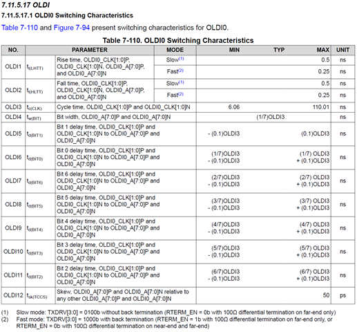

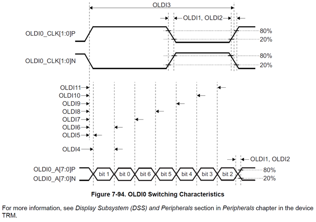

    For AM62x  LVDS/OLDI interface, how to interpret the length from the parameter in datasheet.
    Actually did not find timing data in datasheet.
  • Trace length requirements are considered for peripherals that have a specific requirement. For example, we define PCB trace delays for the eMMC and SD Card peripherals because PCB trace delays had to be included in our timing closure of AM62x for it to meet the requirements defined in the respective industry standard.
    In some cases, we do not have an industry standard.
    For some of these cases, a peripheral is timing closed based on a compilation of timing data from a set of devices which are likely to be connected to the peripheral. This collection of timing data is used in lieu of an industry standard and PCB trace delay expectations are included in our timing closure of AM62x.
    There are also cases where we do not have enough timing data for attached devices to consider the impact of PCB delays. OLDI is an example of this case, where we do not know how much variability a specific display panel allows between the arrival of clock and data signals. Therefore, we only define our timing variability between the source synchronous output signals. The customer must research the requirements of their specific display panel to determine how much margin remains for PCB trace length matching.
