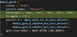

I was able to solve the problem prototypical by deleting the ISR Vector 103 from the node
and reduce the number of available gpios by 16.
