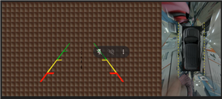

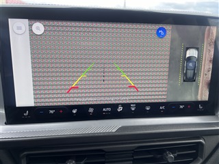

We have another corrupted image coming from a vehicle. Issue was persistent while shift from Drive to Reverse (Please see the video). and it recovered in the same cycle.
Please urgently support us on how can we get such behavior knowing that our rendering process is map to EVE core. So is there any kind of flag error that we can check on or what can we check on EVE to investigate this issue.

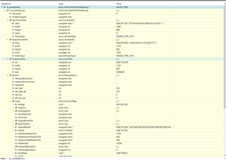

  • memory dump from the requested structures is below :
    LUT_Extract.zip

  • Trial by giving repeated pattern in srcMap (from DSP side) resulted in below pattern :
    It seems a "similar" pattern to what was seen at FORD site , can you please help to identify what are the causes that can lead to a repeated pattern ? I checked internally and the generation of the LUT was based on a TI example so I believe we need to review that in a call. Let us know when you are available. Also, we need to consider the probability if the LUT data is passed correct and EVE is using the data from one tile only repeatedly to construct output video image.

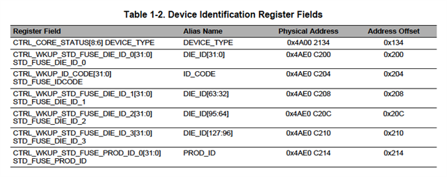

  • Hello,  As we discussed, can you extract the DIE_ID (and neighboring) registers highlighted here:
    Kyle
