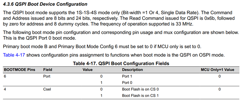

Hello, we are designing a PCB based on the AM69 processor, and we would like to boot from QSPI. Please see the following except from the TRM:
My question is concerning the sentence, "Primary boot mode B and Primary Boot Mode Config 6 must be set to 0 if MCU only is set to 0." I was interpreting this sentence to mean the following:
  1. When MCU Only=0, Primary Boot Mode B (that is, pin BOOTMODE00) must be 0, which is consistent with table 4-8. This makes sense.
  2. When MCU Only=0, Primary Boot Mode Config 6 (which I take to mean pin BOOTMODE06) must also be 0. According to table 4-17 shown above, this means that QSPI "Port 1" will be used for booting.
However, table 4-17 above seems to also indicate that when MCU Only=1, the value of the "port" configuration field is implicitly zero, which would mean that QPSI "Port 1" would be used in that situation as well.
So it would seem that it is impossible to select QPSI "Port 0" for booting, and this makes me think that I must not be understanding something correctly. Please let me know where I am mistaken.
Thanks and best regards,
Dave

    Update from our expert:
    • When MCU Only=0, Primary Boot Mode B (that is, pin BOOTMODE00) must be 0, which is consistent with table 4-8. This makes sense.
    >> This is correct.
    1. When MCU Only=0, Primary Boot Mode Config 6 (which I take to mean pin BOOTMODE06) must also be 0. According to table 4-17 shown above, this means that QSPI "Port 1" will be used for booting.
    >>  There seems to be a typo in TRM. Correct Statement is when MCU Only=0, Primary Boot Mode Config 6 can be either 0 (Port 1) or 1 (Port 0)
    >> In MCU only Mode(MCU Only=1), the BOOTMODE pins(here it is BOOTMODE00 and BOOTMODE06) are ignored, and default settings will work for QSPI boot, which is Port 1. So QSPI cannot boot through Port0 in MCU only mode.
    I will get the typo corrected in the next revision of our TRM. Thanks for pointing it out.
