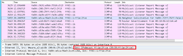

The "ethtool -S <dev>" command drops the following:
ale_drop:
rx_port_mask_drop:
ICMPv6

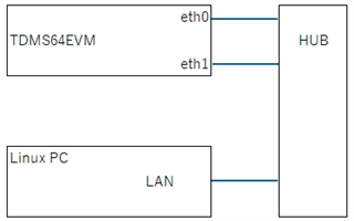

    Could you please describe the topology of how the ports are hooked up with their link partners?
    Schuyler
  • The connections are as follows.
    This can be reproduced from a Linux PC using the following 'ndisc6' command.
    ###EVM###
    eth0 inet6 fe80::ae1f:fff:fe84:4ca
    eth1 inet6 fe80::72ff:76ff:fe1e:2fce
    #eth0,1 LinkUP (eth1 is later.)
    root@am64xx-evm:~# switch-config -d
    K3 cpsw dump version (1) len(11704)
    ALE table dump ents(512):
    0 : type: vlan , vid = 0, untag_force = 0x7, reg_mcast = 0x0, unreg_mcast = 0x0, member_list = 0x7
    1 : type: ucast, addr = ac:1f:0f:84:04:ca, ucast_type = persistant, port_num = 0x0, Secure
    2 : type: mcast, vid = 0, addr = ff:ff:ff:ff:ff:ff, mcast_state = f, no super, port_mask = 0x7
    3 : type: mcast, addr = 33:33:00:00:00:01, mcast_state = f, no super, port_mask = 0x1
    4 : type: mcast, addr = 01:00:5e:00:00:01, mcast_state = f, no super, port_mask = 0x1
    5 : type: ucast, addr = 70:ff:76:1e:2f:ce, ucast_type = persistant, port_num = 0x0, Secure
    6 : type: mcast, addr = 33:33:ff:1e:2f:ce, mcast_state = f, no super, port_mask = 0x1
    7 : type: mcast, addr = 01:80:c2:00:00:00, mcast_state = f, no super, port_mask = 0x1
    8 : type: mcast, addr = 01:80:c2:00:00:03, mcast_state = f, no super, port_mask = 0x1
    9 : type: mcast, addr = 01:80:c2:00:00:0e, mcast_state = f, no super, port_mask = 0x1
    10 : type: mcast, addr = 33:33:00:00:00:fb, mcast_state = f, no super, port_mask = 0x1
    root@am64xx-evm:~#
    ###Linux PC###
    user@user-VirtualBox:~$ ndisc6 fe80::ae1f:fff:fe84:4ca enp0s8
    Soliciting fe80::ae1f:fff:fe84:4ca (fe80::ae1f:fff:fe84:4ca) on enp0s8...
    Timed out.
    Timed out.
    Timed out.
    No response.
    user@user-VirtualBox:~$ ndisc6 fe80::72ff:76ff:fe1e:2fce enp0s8
    Soliciting fe80::72ff:76ff:fe1e:2fce (fe80::72ff:76ff:fe1e:2fce) on enp0s8...
    Target link-layer address: 70:FF:76:1E:2F:CE
    from fe80::72ff:76ff:fe1e:2fce
    #Now reconnect eth0.

    #eth1 is still connected, but "mcast, addr = 33:33:ff:1e:2f:ce" has been removed.
    ###Linux PC###
    Target link-layer address: AC:1F:0F:84:04:CA
    from fe80::ae1f:fff:fe84:4ca
    Timed out.
    Timed out.
    Timed out.
    No response.
