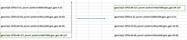

Comparing kernel 5 and 6 we have discrepancy in cat /sys/kernel/debug/gpio.
Correct: GPIO3 is used with
481ae000
root@testboard_0001:~# cat /sys/kernel/debug/gpio
gpiochip0: GPIOs 0-31, parent: platform/44e07000.gpio, gpio-0-31:
gpiochip1: GPIOs 32-63, parent: platform/4804c000.gpio, gpio-32-63:
gpiochip2: GPIOs 64-95, parent: platform/481ac000.gpio, gpio-64-95:
gpiochip3: GPIOs 96-127, parent: platform/481ae000.gpio, gpio-96-127:
gpio-105 (                    |ksz8895 irq         ) in  hi IRQ
gpio-106 (                    |ksz8895 reset       ) out lo
Wrong: GPIO0 is used with
44e07000
root@beagletest:~# cat /sys/kernel/debug/gpio
gpiochip0: GPIOs 0-31, parent: platform/4804c000.gpio, gpio-0-31:
gpiochip1: GPIOs 32-63, parent: platform/481ac000.gpio, gpio-32-63:
gpiochip2: GPIOs 64-95, parent: platform/481ae000.gpio, gpio-64-95:
gpiochip3: GPIOs 96-127, parent: platform/44e07000.gpio, gpio-96-127:
gpio-105 (                    |ksz8895 irq         ) in  lo IRQ
gpio-113 (                    |cd                  ) in  lo IRQ ACTIVE LOW
How to solve this?  How to have the same order according to addresses like in kernel 5?

    According to https://e2e.ti.com/support/processors-group/processors/f/processors-forum/1391762/processor-sdk-am335x-porting-gpio-from-sdk7-sysfs-to-sdk9-libgpiod-not-working/5363998#5363998, specification of GPIO0-GPIO3 is a solution? How? Could be the specification written like in   (from OCP taken)?
    Where could it be specified in device tree  ?
    solved with
    AM3352: Setting GPIO values in kernel 6.1.46
    We needed GPIO3_9 and GPIO3_10. In kernel 5 it was 105 and 106, and it should be the same in kernel 6. But now it has to be 73 and 74 in kernel 6.
