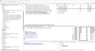

2) Next question is,
I tried to flash Hellowolrd example code from the SDK 'mcu_plus_sdk_am62x_10_00_00_14' and run it on MAIN_Cortex_R5_0_0 which is Device Manager core.
Followed the procedure given in TIREX and able to load the program 'hello_world_am62x-sk-lp_r5fss0-0_freertos_ti-arm-clang' output (.out format) via CCS.
I expect this program should stop at main once I give 'Run'. But its showing like the core is running and I'm not able to put any breakpoints in main function or any other functions.
Why such behavior is observed? Kindly advise me.
