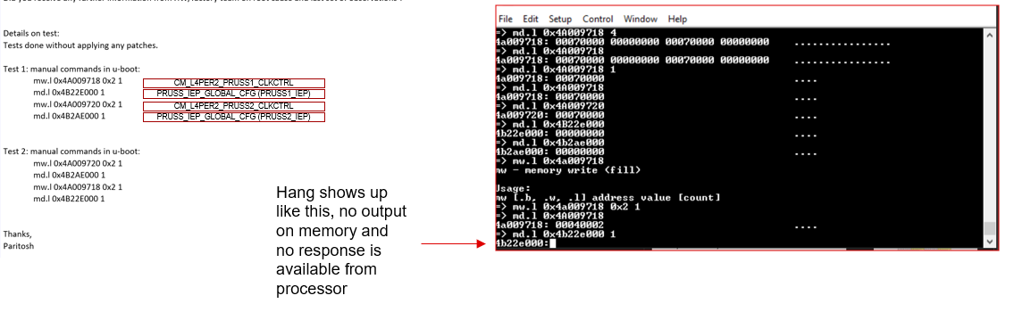

Sorry for the rather late reply.
We have confirmed that the problem has been resolved (Kernel does not stop) using the method you reported.
■AM5718: hangs after calling kernel on AM5718
https://e2e.ti.com/support/processors-group/processors/f/processors-forum/1396658/am5718-stops-after-calling-kernel-on-am5718/5346129#5346129
The command below is for which Errata you informed us. What kind of effect does it have? mw.l 0x4A009720 0x2 1 mw.l 0x4A009718 0x2 1
