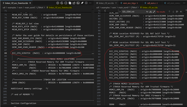

TDA4VH-Q1: freertos sdl example apps failed but pass on Baremetal
Part Number: TDA4VH-Q1
freertos build command :
ti-processor-sdk-rtos-j784s4-evm-10_00_00_05/sdl/binary/esm_main_app/bin/j784s4$ make esm_main_app  SOC=j784s4 BUILD_OS_TYPE=freertos
execution logs:
FS  ver: 10.0.8--v10.00.08 (Fiery Fox)
mcuClkFreq 1000000000
ESM Example Application
ESM_ECC_Example_init: Init MAIN ESM complete
Failed to configure the RAT index 2 address 0x20000000
SDTF_init: Error initializing R5F core ECC: result = -1
 ESM Safety Example tests: unsuccessful
 ESM UC-6 and UC-7 Test Failed.
Some tests have failed.
main.c:297:esm_app:FAIL
1 Tests 1 Failures 0 Ignored
FAIL
