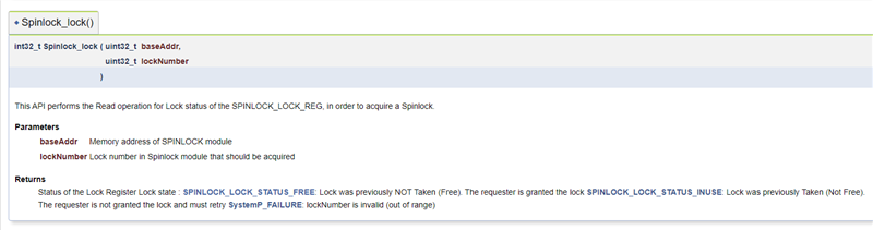

Hi Nelson,
Thanks for your query.
To check whether a spinlock is free to use or not. Use the Spinlock_lock() API.
Please refer below image.
Please refer Spinlock_API for more details.
