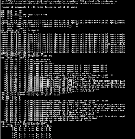

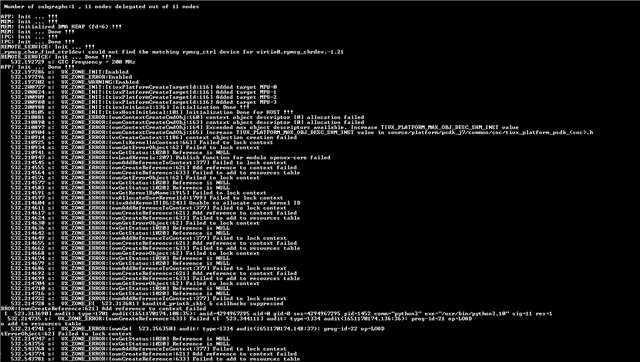

issue: I have linux filesystem booted via sd card which has vision apps running for all the cores in j784s4 soc, we created a test application to be running in parallel to the machine learning model
our test application will be running on C7x_2 core. The issue is when running our custom model inference in parallel to C7x_2 I am encountering this error which is shown below
[NOTE : I dont see this issue when vision apps are running in all the cores after booting the sd card, only when I run my our model I am seeing this rpmsg_ctrl error while parallely running test app on C7x_2 core ].
Please help us in resolving it.
Madhu

  • Hi Asha
    Thanks for your reply ,
    1.You've evaluated the model running on the board on C7x_1 with no other applications running, and this is working fine -
    Yes our model runs successfully on the board without any issues
    2. This error only occurs when you have your model running on C7x_1, and with your test application running on C7x_2?
    -Yes while running the model in parallel to our testapp this issue occurs , let me share the original error snap here
    Madhu
