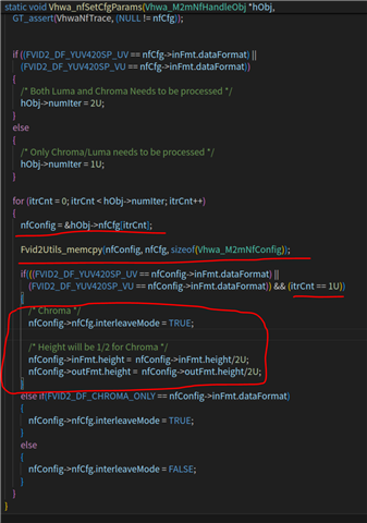

  • 3. If I want to filer both Y and UV plane, I think I should run NF node twice with input_interleaved =0(for Y) and 1(for UV). Is it right?
    I suppose PDK driver can do that for you in that case according the the e2e thread you referred to above (I am not familiar with driver details though).
    In "vhwa_m2mNfApi.c", you can find that 2 iterations are needed for Y+UV.

    In your shared BLNF output images, both Y and UV are modified from input.
    I guess you have applied patch in the other e2e thread and the PDK driver has already triggered BLNF for both Y and UV.
  • Hi Gang,
    Yes, I have applied patch in case 4645951 I linked in previous reply. The purpose is to support NV12 input.
    I looked through the code you attached. It does iterate twice if input is NV12 to copy nfCfg content to different address of hObj ( nfConfig = &hObj->nfCfg[itrCnt]). But based on your code, the problem is nfCfg is not an array. Therefore, hObj->nfCfg[itrCnt] have same nf configs for 2 iterations. For my understanding, denoise parameters, e.g. sigma_r and sigma_s for Y and UV can be different. This code is showen that nf config is kept same even if input_interleaved is 1. I think it can explain why the dennoising results of my test cases are same comparing between input_interleaved is 0 and 1.
    Please help correct me.
    Thanks.
    Zhishen
  • Hi zs,
    If you need to change Y and UV parameters, it might be better for you to call BLNF for Y and UV separately with your desired parameters.
    The "input_interleaved" field in H/W register is only for input format, it has no other effect on H/W.
    Since driver can see input image format, it does not need to check inpput_interleaved for anything.
