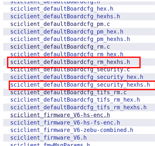

    2-Regarding the "boardConfig", how is this file generated and where is located in the SDK?
    Boardconfig file can be found at <RTOS_SDK>/<pdk>/packages/ti/drv/sciclient/soc/V6/
    when you build the board config, .c file gets compiled and get converted to .h format which is nothing but a binary in c array format.

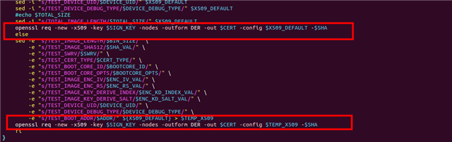

    3-Is the "x509 certificate" automatically generated during the generation of the SBL HS image (i saw a relation through common.mk file) or this is something that i should run apart manually running the x509CertificateGen script?
    When we build the sbl for HS device the build infra make use of x509CertificateGen.sh script to sign the SBL image.You can have a look at common.mk file for the same.

    5-Once triggered the script, where would be the output x509 certificate located and which name/extension it would have?
    When you build the sbl for hs device you will get the signed binary at location: RTOS_SDK/packages/ti/boot/sbl/binary/<board>_evm_hs
    intermediate file like certificate will be get removed at the end of the script execution after concatenating it with binary.

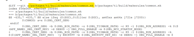

    6-Does this x509CertificateGen script also encrypts and signs the HS image (and also the configBoard) or just generates the x509 certificate?
    Current PDK build infra will only sign the image not encrypting it for better boot performance, though you can also do the encryption using same script.
    7-What determines if a "non-encrypted" vs "encrypted" SBL HS bin image is needed or this is just up to client requirements?
    It depends on the customer what they want.PDK does support both sign or encrypted + sign.
    8-I noticed we can also create the x509 certificate through OpenSSL, so, what is the difference between using this method and the x509CertificateGen script?
    x509CertificateGen.sh script make use of opensll command only, the script just provide ease of use.
    9-Could you please share me the updated steps applicable for SDK-RTOS V10.00.00.27 to encrypt/compile the HS generated image (steps in PDK 5.2.6.3 doc seems to be outdated)?
    Please go though the app not to encrypt the image:https://www.google.com/url?sa=t&source=web&rct=j&opi=89978449&url=https://www.ti.com/lit/pdf/sprad04&ved=2ahUKEwi-6ZaqqIOJAxVJe2wGHVtKMscQFnoECBQQAQ&usg=AOvVaw2EnOf5MXjIhegsGhkOzwJh
    10-Could you please also share me the steps applicable for SDK-RTOS V10.00.00.27 to sign the HS generated image? Do these apply also to sign the boardConfig?
    Build infra of  the PDK already taking care of signing board config,
    These are signed board config
    Suggested to go through x509CertificateGen.sh script to understand the signing mechanism in detail.

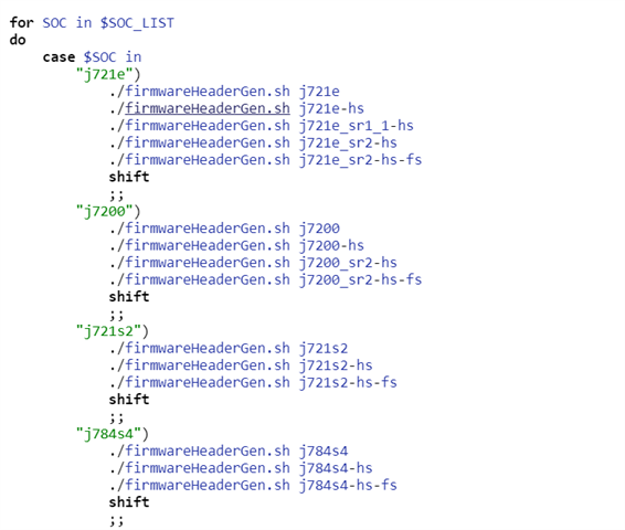

    2-I noticed that there is another script called "fimwareHeaderGen", is this the one used to re-generate TIFS/boardConfig (or SYSFW)? could you provide me more information about this and an example of its usage?
     "fimwareHeaderGen" is used to generate the final tifs bin from the signed and encrypted tifs binary. for detail on the usage you can look at the "sysfw_migrate.sh" script

    how can i re-generate and sign/encrypt the tifs
    TIFS comes as a part of TI delivery, encrypted TIFS with TI MEK key and  signed certificate with TI MPK key are delivered by the TI as a part of SDK. Customer just need to sign the outer certificate of it using root trust keys. For this you can make use of fimwareHeaderGen.sh script.

    Is there a command or script for this?
    As said earlier to sign  tifs inner certificate with root trust keys you will make use of fimwareHeaderGen.sh and other component like SBL,BOARDCFG,APP image get signed using  x509CertificateGen.sh script.
