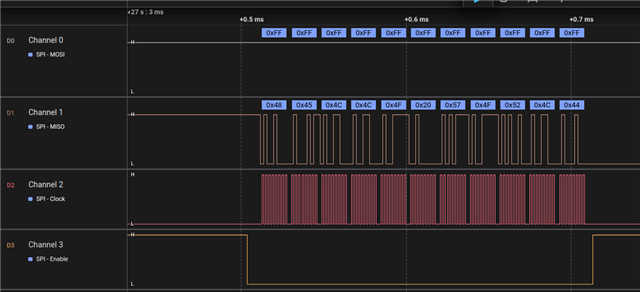

Currently, MCU_SPI0 transmits data over MCU_SPI0_D1 (MOSI). For our application, MCU_SPI0_D1 needs to be MISO and MCU_SPI_D0 be MOSI.
root@j722s-evm:/# devmem2 0x04B0012C
/dev/mem opened.
Memory mapped at address 0xffffbea84000.
Read at address  0x04B0012C (0xffffbea8412c): 0x200103C8
root@j722s-evm:/# ./spidev_test -v -D /dev/spidev1.0 -p "HELLO WORLD"
spi mode: 0x0
bits per word: 8
max speed: 500000 Hz (500 kHz)
TX | 48 45 4C 4C 4F 20 57 4F 52 4C 44 __ __ __ __ __ __ __ __ __ __ __ __ __ __ __ __ __ __ __ __ __  |HELLO WORLD|
RX | FF FF FF FF FF FF FF FF FF FF FF __ __ __ __ __ __ __ __ __ __ __ __ __ __ __ __ __ __ __ __ __  |...........|
Reading the value of MCSPI_CFG_CH0CONF[16:18], it seems like D0 should be selected for transmission, but data is still being sent out over D1.

Also tried adding CONFIG_SPI_MASTER=y and removing CONFIG_SPI_SLAVE from defconfig, wondering if spidev might be in peripheral mode, but no change.
Could you advise how to implement  D1=MISO and D0=MOSI?
