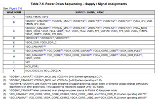

My customer found that power-down sequence does not match between AM625 datasheet and TPS65219 TRM(SLVUCL0).
Below is AM625 datasheet Figure 7-6.
Suppose VDD_CORE is 0.75V, above waveform requires,
Waveform C and D are shut down, then waveform G goes off.
On the other hand, below is TPS6521902 power down sequence. Waveform G(Buck1 / 0.75V) is shut down at the same timing as Waveform C(Buck2, LDO3, LDO1) and Waveform D(LDO4).
Is this valid power down sequence?

  • Hi Koichiro,
    As shown in the AM62x datasheet, VDDSHV4/5/6 (waveform D) were designed to support power-up, power-down, or dynamic voltage change without any dependency on other power rails. All the remaining rails (except VDD_CORE and CANUART) can be turned OFF at the same time.
    The main power-down requirement is for the CORE rails, if you are running VDD_CORE at 0.75V, then it must turn-OFF after VDDR_CORE. These are waveforms G and H. The power-down sequence configured on TPS6521902 meets this requirement.
