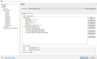

  • Hello Xin,
    Can you make sure you have all the libraries linked correctly?

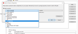

    Right click the project and go to Show Build Settings...
    Then go to General->Products(Tab)
    You have to make sure that you are adding the DSP library to your project: Click Add->Drop_Down_Menu
    -Josue

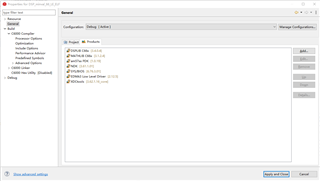

  • Hello Josue, thanks for your reply.
    I didn't add the DSP library to the project before indeed. But after I add them, the error still occurs and the error log doesn't change.
    **** Build of configuration Debug for project DSP_minval_66_LE_ELF ****

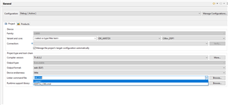

  • Hello Xin,
    Yes, I believe it was building already.. I looked up the error in e2e and got to this thread: https://e2e.ti.com/support/processors-group/processors/f/processors-forum/677543/rtos-am5728-memory-range-overlap
    So I removed the linker file and rebuilt and it worked..

    I chose none before building..
    Let me know if this works for you.
    -Josue
  • Thanks for your reply Josue. I followed your instruction and it built project successfully.
