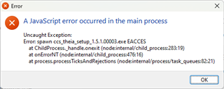

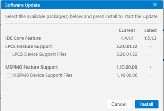

  • Ricky,
    Thanks for taking my question. Details line in Help, About says it is Version: 1.4.1.1. I click Help, Check for updates, they get found, I agree to install
    Things get downloaded, then I get prompted to close CCS,
    I do agree, and then the error happen
  • Victor,
    The EACCES error seems to indicate that there is permission/access issue with running the installer to perform the update.
    Do you maybe have any security or anti-virus software that might be preventing access to the update process?
    Also, are you able to start CCS Theia with Administrator access? (ie; Right click on ccstudio.exe and 'Run as administrator'._
    Ricky
  • Hello!
    That is pretty ordinary Win11 machine, nothing special is there besides Microsoft Defender. I've tried with elevated privileges first and indeed it worked. So I can't tell for sure that disabling Defender could help too. You know, it is somewhat counterintuitive to run IDE as administrator in order to get it self-updated. I remember earlier times CCS updater was asking for elevated privileges after being launched, not before. Either way, I was able to perform update. One minor issue though is that in the start menu the program is still found as 1.4.1, though Help, About does show correct version 1.5.1.3.
  • Victor,
    Yes, the admin privileges shouldn't be needed for applying updates, but when users are running into the EACCES issue during the update process, this is a known workaround for now. We will need to investigate how common this issue is, and what the cause is to see we can implement a better solution for when users run into this.
    As for the menu shortcut string, I'll file a bug for this to investigate further.
