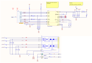

We are trying to cost optimize our current board design, based on bbb black which has SMSC LAN8710/LAN8720. We want to replace it with TI DP83825I PHY.
We have issue that in UBoot with the new design we can establish link over the PHY but in Linux this is not the case. In UBoot eth works and the moment that linux driver is loaded there is no more link towards the network.
Schematic
Phy is connected over MDIO and RMII to am3352 processor and pinmux is set as it should be:
Then linux/uboot device tree is updated with this pinmux:

And device tree is updated to use this pinmux and also to configure cpws emac0 to use this new phy over MDIO:
&cpsw_emac0 {
 phy-handle = <&ethphy0>;
 phy-mode = "rmii";
 ti,davinci-rmii-en = <1>;
&mac {
 slaves = <1>;
 pinctrl-names = "default", "sleep";
 pinctrl-0 = <&myrmii1_pins_default>;
 pinctrl-1 = <&myrmii1_pins_sleep>;
 status = "okay";
&davinci_mdio {
 pinctrl-0 = <&mymdio1_pins_default>;
 pinctrl-1 = <&mymdio1_pins_sleep>;
 status = "okay";
 ethphy0: ethernet-phy@0 {
   reg = <0>;
   ti,rmii-mode = "slave";
DP83825I works in slave mode and MAC is providing clock of 50MHz.

We are using buildroot to build our image and beagleboard/linux. If there is something missing I can provide more info. Like ethtool:

More I look at this I have more questions :). Is it possible that in linux rmii clock for am3352 can be only the input? Is it possible that we have to provide external 25MHz or 50MHz depending on master/slave mode?
I tried in am3352 pinmux tool to configure rmii_ref_clk to be output, but that didn't change anything.
    For RMII mode an external clock is required. I do not see the clock in the schematic snippet supplied. How is the 50MHz clock supplied?
    Schuyler
  • Oh, thanks for the answer.
    We do not have external clock we are trying to use am3352 internal RMII clock which is generated somehow in the UBoot (and there it works, we can boot then from tftp). In Linux, once the driver is loaded, RMII 50MHz clock is started for like 1 sec and then it stops.
    I guess if U set the mode in pinmux tool for RMII interface to mode0 and we set it like output it should generate the clock.
    	myrmii1_pins_default: myrmii1-default-pins {
    		pinctrl-single,pins = <
    			AM33XX_IOPAD(0x90c, PIN_INPUT | MUX_MODE1) /* (H17) gmii1_crs.rmii1_crs_dv */
    			AM33XX_IOPAD(0x910, PIN_INPUT | MUX_MODE1) /* (J15) gmii1_rxer.rmii1_rxer */
    			AM33XX_IOPAD(0x914, PIN_OUTPUT | MUX_MODE1) /* (J16) gmii1_txen.rmii1_txen */
    			AM33XX_IOPAD(0x928, PIN_OUTPUT | MUX_MODE1) /* (K17) gmii1_txd0.rmii1_txd0 */
    			AM33XX_IOPAD(0x924, PIN_OUTPUT | MUX_MODE1) /* (K16) gmii1_txd1.rmii1_txd1 */
    			AM33XX_IOPAD(0x940, PIN_INPUT | MUX_MODE1) /* (M16) gmii1_rxd0.rmii1_rxd0 */
    			AM33XX_IOPAD(0x93c, PIN_INPUT | MUX_MODE1) /* (L15) gmii1_rxd1.rmii1_rxd1 */
    			AM33XX_IOPAD(0x944, PIN_OUTPUT | MUX_MODE0) /* (H18) rmii1_refclk.rmii1_refclk */
    U can see that rmii clock is set as the output and that mode is 0.
    Or I didn't understand this well?
    In U boot pinmux is also set like that:
     static struct module_pin_mux rmii1_pin_mux[] = {
    -    {OFFSET(mii1_crs), MODE(1) | RXACTIVE},              /* MII1_CRS */
    -    {OFFSET(mii1_rxerr), MODE(1)  | RXACTIVE},           /* MII1_RXERR */
    -    {OFFSET(mii1_txen), MODE(1)},                        /* MII1_TXEN */
    -    {OFFSET(mii1_txd0), MODE(1)},                        /* MII1_TXD0 */
    -    {OFFSET(mii1_txd1), MODE(1)},                        /* MII1_TXD1 */
    -    {OFFSET(mii1_rxd0), MODE(1) | RXACTIVE},             /* MII1_RXD0 */
    -    {OFFSET(mii1_rxd1), MODE(1) | RXACTIVE},             /* MII1_RXD1 */
    -    {OFFSET(rmii1_refclk), MODE(0) | RXACTIVE},          /* RMII1_REFCLK */
    -    {OFFSET(mdio_clk), MODE(0) | PULLUP_EN},             /* MDIO_CLK */
    +    {OFFSET(mii1_crs), MODE(1) | PULLUP_EN | RXACTIVE},   /* MII1_CRS */
    +    {OFFSET(mii1_rxerr), MODE(1) | PULLUP_EN | RXACTIVE}, /* MII1_RXERR */
    +    {OFFSET(mii1_txen), MODE(1)},                         /* MII1_TXEN */
    +    {OFFSET(mii1_txd0), MODE(1)},                         /* MII1_TXD0 */
    +    {OFFSET(mii1_txd1), MODE(1)},                         /* MII1_TXD1 */
    +    {OFFSET(mii1_rxd0), MODE(1) | PULLUP_EN | RXACTIVE},  /* MII1_RXD0 */
    +    {OFFSET(mii1_rxd1), MODE(1) | PULLUP_EN | RXACTIVE},  /* MII1_RXD1 */
    +    {OFFSET(rmii1_refclk), MODE(0) | RXACTIVE},           /* RMII1_REFCLK */
    +    {OFFSET(mdio_clk), MODE(0) | PULLUP_EN},              /* MDIO_CLK */
    +    {OFFSET(mdio_data), MODE(0) | RXACTIVE},              /* MDIO_DATA */
         {-1},
    As U can see in UBoot even I left the clock as RX and am3352 is still generating that clock.
    May I ask, is there something in Linux driver for CPSW that will do signal analysis of the rmii and will say ah no, we are not going to use this PHY without external clock?
    My understanding is that due to the tight requirement of aligning the both TX and RX to the same clock the PHY needs to provide the clock not the AM335x. Let me discuss this point with a HW colleague.
    Did you previous design use RMII for the interface mode?
    Schuyler
  • Previous design was mii not rmii but it was with external clock. But we wanted to reduce the price of the total product by using TI phy, no external clock, and some other cost optimizations. But yeah, phy not working will not save cents Slight smile.
