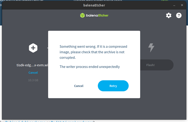

Hi all,

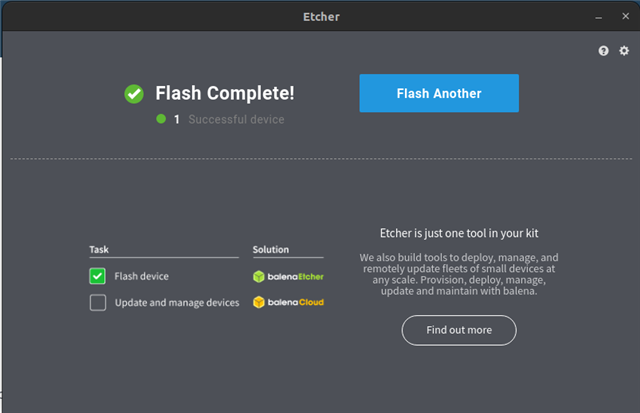

Due to the latest version(V1.19.x) Balena etcher have some bugs will cause flash error report. regarding this error, pls use old version Balena tool to work around. below is the download link for V1.7.x, I have validated V1.7.9 and V1.5.22. Just for your reference.
https://github.com/balena-io/etcher/releases?page=13
Balena flash error sreenshot as below:
BR,
