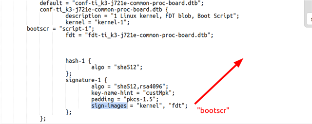

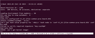

Hello Team,
On our custom board, previously we were working on below sdk version.
ti-processor-sdk-linux-j7-evm-08_01_00_07-Linux
ti-processor-sdk-rtos-j721e-evm-08_01_00_13
Now, we upgraded to below sdk version:
ti-processor-sdk-linux-adas-j721e-evm-09_02_00_05
ti-processor-sdk-rtos-j721e-evm-09_02_00_05
In sdk 9.2, we observed signing is happening via binman.
Currently, we have a script file (svcu_uboot_script.txt) which needs to be signed and should be part of fitImage.
To achieve this, we have added the node in fitimage.its file located in ti-processor-sdk-linux-adas-j721e-evm-09_02_00_05/board-support/ti-linux-kernel-6.1.80+gitAUTOINC+2e423244f8-ti/

                default = "conf-ti_k3-j721e-common-proc-board.dtb";
                conf-ti_k3-j721e-common-proc-board.dtb {
                        description = "1 Linux kernel, FDT blob, Boot Script";
                        kernel = "kernel-1";
			bootscr = "script-1";
                        fdt = "fdt-ti_k3-j721e-common-proc-board.dtb";
                        hash-1 {
                                algo = "sha512";
                        signature-1 {
                                algo = "sha512,rsa4096";
                                key-name-hint = "custMpk";
                                padding = "pkcs-1.5";
                                sign-images = "kernel", "fdt";

>Signing it and generating svcu-uboot-script.sec file.
${TI_SECURE_DEV_PKG}/scripts/secure-binary-image.sh /home/kishore/ti-processor-sdk-linux-adas-j721e-evm-09_02_00_05/board-support/prebuilt-images/svcu_uboot_script.txt /home/kishore/ti-processor-sdk-linux-adas-j721e-evm-09_02_00_05/board-support/ti-linux-kernel-6.1.80+gitAUTOINC+2e423244f8-ti/svcu-uboot-script.sec
>Adding this in above fitImage.its file
>But once we flash it on the board, we see below error at uboot.
Can you please help us, if we are missing anything here ?

    Thank you for your inputs.
    We followed above suggestions now.
    Now, it is going ahead, but our script functionality is not visible.
    Getting the below error :
    Could not find configuration node
    load of <NULL> failed
    Working FDT set to 83000000
    Loading Kernel Image
    Thanks in advance.
    Kishore
  • Hi Diwakar,
    One more observation, while building, we do not see our script- entry in default configuration log.
    Kernel and fdt entry is visible as shown below.
    Also the " Description: 2 Linux kernel, Boot Script, FDT blob" is getting updated in the log.
    Also do not see, load address entry in Image 35 (script-1).
    For your reference, we are attaching the updated fitImage.its file here.

  • HI Kishore
    I am not sure on how boot script will get loaded by UBOOT in case of fit image you might want to look into this.
    https://github.com/u-boot/u-boot/blob/master/doc/usage/cmd/source.rst
    Diwakar
