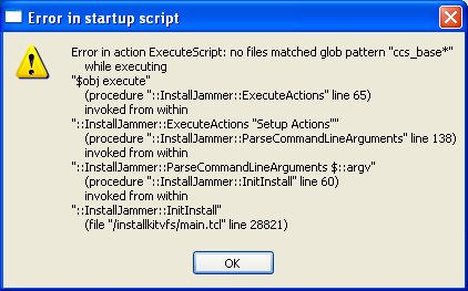

Durig the install of MCSDK 2 in windows XP I am getting:

    I did as you said, unchecked evrything, but MCSA, but the installer still crashed.  I installed CCS5.0.3 before atempting to install MCSDK, should have I reversed the sequence?

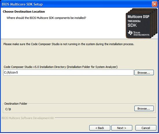

    Both CCS5.0.3 and MCSDK are being put at c:\ti
    I uninstalled CCS5.0.3, reran the MCSDK installer and it still crashed:
    Lee
  • The installer needs CCS v5 to be installed. Please re-install CCS v5.0.3. If you choose to install CCS v5 in c:\ti, then you should see ccsv5 directory in c:\ti. Then re-run the installer. The installation location window of the installer should look like the picture below (note c:/ti/ccsv5 entry). The installer should install fine.
