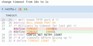

    Below is our config related to Block size
    CONFIG_IP_DEFRAG=y
    CONFIG_NET_MAXDEFRAG=65535
    CONFIG_TFTP_BLOCKSIZE=65535
    and timeout is down from 10s to 1s
    #define TIMEOUT 1000UL

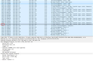

  • I'd like to add more info:
    Package capture from WireShark show that there are 2 timeout with Read Request package.
    the time between 2 data packet is not greater than downloading of tispl.
    Why the average speed is much smaller than? Does it calculate all the time that include ARP packet?
    Cong.

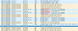

  • What is your network architecture or topology. Is there a DHCP server? 192.168.1.20 is the TFTP server, 192.168.1.2 is the AM625? A Linux server running TFTP server connected in a dedicated LAN to the AM625 device? Or is it connected using some enterprise network?
    Looking at the packet capture in wireshark couple things jump out.
    1. TFTP looks to be using 512 byte frames, could there be some setting in the TFTP server limiting to such small MTU? I would have expected ~1500 bytes. This is probably minor.
    2. At the very beginning it looks like it takes 30s or so to get a ARP response. 192.168.1.20 is looking for 192.168.1.0 (default gateway) but does not get a response for a long time. Then loading tispl to 192.168.1.2 begins. This points to some issue with default gateway settings?
    3. Just from the wireshark the bandwidth of loading tispl.bin looks to be (start at 66.872 seconds into capture, end at 67.403) 0.53 seconds. While the u-boot.img is (start 73.334, end at 76.231) is 2.9 seconds. File sizes are 869kB and 666kB so bandwidth should be around 1.6MB/s and 0.23MB/s. This does not match your screenshot printout of 2.2MB/s and 44kB/s? Are those bandwidth calculated by your SW? Wireshark shows bandwidth delta of 6-7x not 50x.
    4. Based on the item 3 it looks like loading u-boot.img image acknowledging each TFTP frame takes 3-5x as long as each frame of tispl.bin. Is the TFTP client software, cache settings and memory map identical?

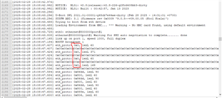

    I got some new information when debugging inside the kernel and noticed that initially there was no data available.
    this is where i put log in kernel
    I observed the two logs simultaneously, and found that these two points were at the same time.
    From here we can see that the cause lies in the initialization process and connection to the TFTP server.
    I attach the log here 6428.Log_debug.zip
    Huy
  • From here we can see that the cause lies in the initialization process and connection to the TFTP server.

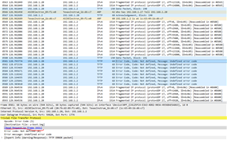

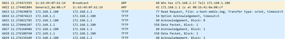

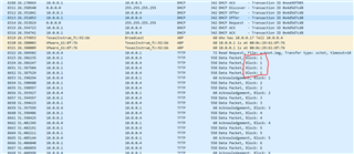

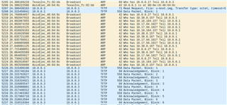

  • From all three wireshark logs, one screenshot at the beginning and then the two from the zip files (one Windows, one Linux) there looks to be a repeating pattern. Loading of tispl.bin, which happens with the boot rom seems to be fine. Sequence is ARP request sent as broadcast from the TI device (beginning of the MAC address 28:B5:e8, OUI registered to TI), response from 192.168.1.20, then the download starts. tispl.bin is loaded quick. Then the second image download (u-boot.bin) using TFTP with probably SPL running has 4-10s of ARP messages before addressing is figured out and download starts. See messages arounf number 3406 in both logs. Once it starts the speed is fine (maybe 2s to download). This MAC and IP address sorting out is why the downloading of u-boot.img appears slow. The logs also have a third file being downloaded where there does not seem to be any addressing issues but the TFTP server says no such file.
    So the issue is sorting out the interaction of the networking stack and ARP resolution/cache in SPL software, media converter, and the TFTP server. What could explain this is some hacks on MAC address, or some dropped Ethernet frames. In the Windows packet capture, the MAC address of the TFTP server seems to be the Gopel Electronic (OUI is 00:06:81), in the Ubuntu one it is an unregistered one (OUI is b6:c3:97). What might fit here is that the SPL misses the ARP response (no 3406 in Ubuntu log), something (the adapter? PHY configuration?) drops the frame. Note the wireshark you capture is from the TFTP server, so shows what leaves and arrives there, not what makes it to the TI device.
    3405	44.230910243	28:b5:e8:cd:57:95	Broadcast	ARP	60	Who has 192.168.1.20? Tell 192.168.1.2
    3406	44.230930572	b6:c3:97:fe:e3:f3	28:b5:e8:cd:57:95	ARP	42	192.168.1.20 is at b6:c3:97:fe:e3:f3
    3407	48.091626906	b6:c3:97:fe:e3:f3	28:b5:e8:cd:57:95	ARP	42	Who has 192.168.1.2? Tell 192.168.1.20
    3408	49.115611308	b6:c3:97:fe:e3:f3	28:b5:e8:cd:57:95	ARP	42	Who has 192.168.1.2? Tell 192.168.1.20
    3409	49.231214758	28:b5:e8:cd:57:95	Broadcast	ARP	60	Who has 192.168.1.20? Tell 192.168.1.2
    3410	49.231232546	b6:c3:97:fe:e3:f3	28:b5:e8:cd:57:95	ARP	42	192.168.1.20 is at b6:c3:97:fe:e3:f3
    3411	50.139626816	b6:c3:97:fe:e3:f3	28:b5:e8:cd:57:95	ARP	42	Who has 192.168.1.2? Tell 192.168.1.20
    3412	50.139890824	28:b5:e8:cd:57:95	b6:c3:97:fe:e3:f3	ARP	60	192.168.1.2 is at 28:b5:e8:cd:57:95
    3413	54.232190870	28:b5:e8:cd:57:95	Broadcast	ARP	60	Who has 192.168.1.20? Tell 192.168.1.2
    3414	54.232311369	b6:c3:97:fe:e3:f3	28:b5:e8:cd:57:95	ARP	42	192.168.1.20 is at b6:c3:97:fe:e3:f3
    3415	54.232538042	192.168.1.2	192.168.1.20	TFTP	71	Read Request, File: u-boot.img, Transfer type: octet, timeout=1
    So need is to sort out the ARP traffic or possible dropped frames after tispl.bin was loaded, when loading u-boot.img is requested.

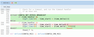

  • Update:
    I tried bypass the ARP packets and speed is improved significant.
    What I did is simply comment this line of code:
    But without ARP packets, it has side effect

    I have some updates after working around the load time of the first 4 frames.
    We worked around this by reducing the timeout duration, which improved the loading speed of u-boot.img. However, when u-boot.img is loading the kernel, the TFTP server sends an error code to the bus in response to the frame loading u-boot.img.
    I have attached the Wireshark file below.

    I changed the codes here:
    This configuration CONFIG_NET_BYPASS_BROADCAST is enabled only when I build tispl.bin.
    I attached the log and Wireshark capture when trying this case.
    /cfs-file/__key/communityserver-discussions-components-files/791/report_5F00_2_5F00_20_5F00_25.zip
    Could you help us analyze this issue and suggest a solution?

    Looking at the capture, the error is being sent by the server, do you agree? Are you seeing any issues with packet sending and receiving?
    Schuyler
  • Hello Schuyler,
    Yes, there is a message from TFTP server, this message is sent from frame 3431, that is, it is a reply to the request from tftp client (board), and at that time it is a frame error of tispl.bin when u-boot is loaded and when loading kernel image, TFTP server sends that message. The problem may be due to the timeout value for tispl.bin being changed.
    after fixing the timeout of spl.bin to reduce the timeout of 4 faulty frames, but it has slowed down the loading of kernel image at uboot,
    so is there a way to both reduce the loading time of u-boot at tispl.bin, and not affect the loading of kernel image at u-boot?

    I debugged on devkit and also found the first 4 frames are all zeros,
    Test information:
        Software: u-boot-2021.01+gitAUTOINC+2ee8efd654-g2ee8efd654, SDK: ti-processor-sdk-linux-am62xx-evm-08.06.00.42
        Hardware: AM62x SKEVM PROC114E3
    I have changed a little bit of uboot source code as below to print out the log:
    Evidence about log and wireshark below, detail in attached file test_devkit28_2_25.zip :
    so i think PHY doesn't affect this error?
    you can test it again on devkit and analyze it
    Huy

    The picture is from our tftp sequence, we are not seeing the duplicate packets. I will include the images we used on the EVM tomorrow. Do you have a switch that is capable of port mirroring the connection between the server and the EVM? This would allow a tap into the packet stream between the server and the EVM.
    Schuyler
    We don't have a switch to try at the moment, do you have any other ideas?
    Are you using uboot in sdk 8.6 to check?
    "Is it odd the that the tftp server in the wireshark log is duplicating the tftp packets. "
    => I switched to a real Ubuntu machine and used a USB to Ethernet adapter to set up a TFTP server. Now, I no longer see duplicate TFTP packets in the Wireshark log.
    In this picture it looks like only block 1 is duplicated and there are no suspicious frames causing 4 frames with Ethertype 0 to be received.
    I think the cause may be in this frame when the board is requesting the ip but it is dropped.
    can you send me your log and wireshark to compare?

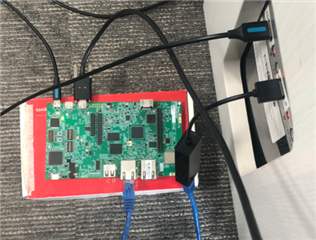

    Could you please attach close up pictures of your EVM both front and back? As close as possible to the device on the board.
    Thank you and Best Regards,
    Schuyler
  • Hi Schuyler,
    It seems that tiboot3 of TI SDK 8.6 and tispl TI SDK 10.x are not compatible with each other.
     I attached pictures our TI DevKit below:
    Huy
  • Hi Huy,
    Thank you for trying the experiment. I am trying to determine if your board has HS/FS silicon mount on it.  The red circles indicate if the device is a HS/FS device. If the letter is a G then it is not an HS/FS device. Why I am asking is that I have setup a 8.6 SDK u-boot for ethernet boot and in the process of trying to see if I see the issue you are experiencing. The EVM I have has an HS/FS device on it. If the images that I have built here do not experience the issue I will send those to you to test on your platform. To align the test your board will need to have an HS/FS device on it.
    Schuyler
  • Hello Schuyler,
    Our Board is GP device and We do not have the TI devkit HS/FS available. Can you send me the same build but for the GP device ?, Does GP and HS affect download time?
    Huy
