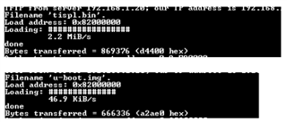

In our system we use uart to download tiboot3.bin, tiboot3.bin down load tispl.bin via tftp and tispl.bin download u-boot.img, we config TFTP blocksize = 65535.
The problem is the speed to download u-boot is much slower than speed tiboot3.bin download tispl.bin
we see that it print loading for long time before print first "#".
Thanks for your helping.

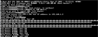

  • after fixing the timeout of spl.bin to reduce the timeout of 4 faulty frames, but it has slowed down the loading of kernel image at uboot,
    so is there a way to both reduce the loading time of u-boot at tispl.bin, and not affect the loading of kernel image at u-boot?
    Hello Huy, You can build tispl.bin and u-boot.img with the modified timeout value which is reducing the timeout of 4 faulty frames, use tispl.bin built from that change. After that undo those changes and use u-boot.img built without changes which will not affect the loading of kernel image at u-boot.
  • Hello  Chintan,
    I just fixed the timeout in SBL and it didn't improve download time,
    and it seems that the first 4 bad frames make the tftp server respond slowly and it affects uboot downloading other files, so it improves in sbl but in uboot it is slow, so there is no improvement from this timeout adjustment workround, the best solution is still to solve the first 4 frames all as 0x0.

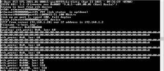

    i want you guys to check if the first 4 frames received by spl are all 0x0?
    because i checked on dev-kit and on our custom board, there is no reason that printing log can affect this, and on your wireshark log there is also a point when requesting IP from devkit 2 times and the board has no response, this proves that the board did not receive the frames, or it skipped because of wrong data, this coincides with the first frame being 0x0 when i put the log in.
    i hope you guys can find the cause of this.
    The image below is your log, the red circled area is the abnormal point.
    Huy

  • Hello Huy, The speed may be the reason that you are having a low throughput while transferring the file. Also it can cause timeout during DHCP request and response. Can you please try 1000Mbps and see whether issue is still there or not ?
  • Hello Chintan,
    Our custom board using is PHY TJA1101B, it only support 100 Mbit/s. so change up 1000Mbps no effect with our
    and we compare between tiboot3.bin loading tispl.bin and tispl.bin loading u-boot.img. tispl.bin load u-boot.img much slower with tiboot3.bin load tispl.bin.
    We have printf debug log on the dev-kit and our custom board, both 4 frame firt is 0x0.
    On our custom board hard static IP. So the board does not need to ask DHCP to provide IP and it will request to load the file immediately. but the first 4 frames are still 0x0, and that's what causes the 4s timeout.
    Can you focus on the first 4 frames and fix them?
    Huy

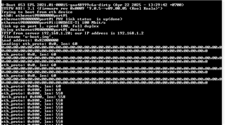

    On the dev-kit, I sorry about mistake speed. We tried speed 1000Mbps, and the first 4 frames are still 0x0.
    Thanks, Huy
  • Hello Huy,
    I have few doubts after I saw the logs provided by you:
    SYSFW ABI: 3.1 (firmware rev 0x0009 '9.0.5--v09.00.05 (Kool Koala)')
    Switching: UART -> ETH RMII boot...
    SPL initial stack usage: 13424 bytes
    Trying to boot from eth device
    Why is it showing ETH RMII boot while we support Ethernet boot on AM62x with RGMII port 1, as described in the documentation here: https://software-dl.ti.com/processor-sdk-linux/esd/AM62X/latest/exports/docs/linux/Foundational_Components/U-Boot/UG-Network-K3.html
    Also I am confused with the logs provided by you, in the wireshark logs I am not able to find the packets with Ethertype 0x0, although it is seen in the debug prints.
    Chintan.
  • Hello Chintan,
    "Why is it showing ETH RMII boot while we support Ethernet boot on AM62x with RGMII port 1, as described in the documentation here:"
    => TI has specifically designed for us to support ETH boot on AM62x with RMII port 1, We are currently using RMII boot on our custom board.

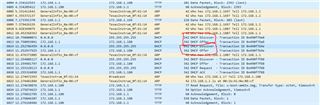

    "Also I am confused with the logs provided by you, in the wireshark logs I am not able to find the packets with Ethertype 0x0, although it is seen in the debug prints."
    => You cannot see it in Wireshark because these are the first 4 frames that are received, not sent to the server.
    Therefore, to see that the first 4 frames are 0x0, you need to add a log print in the source code when receiving the frames.
    As for the analysis in Wireshark, please look at the frames I've highlighted in red.
    When the server queried the MAC address of IP 192.168.1.2, it did not receive a response from the AM62x board until the 5th ARP request(highlighted in blue)
    This matches the logs I previously printed out.
    You should read this thread again to understand this problem clearly.
    Thanks Huy

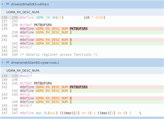

    diff --git a/drivers/net/ti/am65-cpsw-nuss.c b/drivers/net/ti/am65-cpsw-nuss.c
    index f40ee1b28bc..5aefabb2a78 100644
    --- a/drivers/net/ti/am65-cpsw-nuss.c
    +++ b/drivers/net/ti/am65-cpsw-nuss.c
    @@ -141,7 +141,7 @@ struct am65_cpsw_priv {
     #ifdef PKTBUFSRX
     #define UDMA_RX_DESC_NUM PKTBUFSRX
     #else
    -#define UDMA_RX_DESC_NUM 4
    +#define UDMA_RX_DESC_NUM 1
     #endif
     #define mac_hi(mac)    (((mac)[0] << 0) | ((mac)[1] << 8) |    \
    Can you please try this change in am65-cpsw-nuss.c driver and see whether the frames with EtherType 0x0 is reducing to 1 or not ?

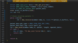

    You can make below changes instead of changing "UDMA_RX_DESC_NUM" to 1, it will drain all packets inside RX buffers, and you won't see any faulty frames.
    index 9b69f36d04d..ba26c861e3f 100644
    @@ -494,7 +494,12 @@ static int am65_cpsw_send(struct udevice *dev, void *packet, int length)
           struct am65_cpsw_priv *priv = dev_get_priv(dev);
           struct am65_cpsw_common *common = priv->cpsw_common;
           struct ti_udma_drv_packet_data packet_data;
    -      int ret;
    +      uchar drain_rx_buffers[1530];
    +      int ret = 0;
    +      /* Drain existing packets */
    +      while (ret==0)
    +              ret = dma_receive(&common->dma_rx, (void **)&drain_rx_buffers, NULL);
           if (!common->started)
                   return -ENETDOWN;
    Chintan.

  • Hello Huy,
    Since there are still 4 'zero frames' and given that updating UDMA_RX_DESC_NUM to 1 had reduced the number of 'zero frames' to 1, it seems to me that setting CONFIG_SYS_RX_ETH_BUFFER=64 did not take effect. It should effectively result in the following section of the am65-cpsw-nuss.c driver being exercised:
    #ifdef PKTBUFSRX
    and CONFIG_SYS_RX_ETH_BUFFER is used to set the value of PKTBUFSRX in:
    include/net-common.h
    which has:
    #define PKTBUFSRX  CONFIG_SYS_RX_ETH_BUFFER
    Alternatively, could you please try changing UDMA_RX_DESC_NUM to 64 similar to the change made earlier when it was set to 1? Please let me know if you start seeing 64 'zero frames' as a result of this. I am wondering if packets are being overwritten or if the issue lies elsewhere.

    I Configured UDMA_RX_DESC_NUM to 64, it is failed to boot up.
    Huy
  • Hello Huy,
    Please revert UDMA_RX_DESC_NUM back to 4 and apply the following diff:

  • Hello Huy,
    Can you please enable DEBUG logs in net/net.c and net/tftp.c for tispl.bin and share the logs?
    Siddharth.
  • Hello Siddharth,
    I enabled DEBUG logs in net/net.c by adding #define DEBUG_NET_PKT 1, and in net/tftp.c by replacing debug() with printf().
    Here is full logs below:
    4_24_2025_2.zip
    Huy

  • Hello Huy,
    In include/net.h, can you increase the value of ETH_PACKETS_BATCH_RECV from 32 to 36? This change will help us find out if the 4 0x0 packets being received are the ones from the previous transaction when eth_rx() was invoked. With this change, please check and let me know if you still see the 4 0x0 packets.
    Siddharth.
  • Hello Siddharth,
    I still see the 4 0x0 packets.
    Do you need full log?
    Huy
  • Hello Huy,
    Thank you for testing it out and sharing the logs. Can you please test the following diff?
    diff --git a/net/tftp.c b/net/tftp.c
    index 6fdb1a821a8..cc998ee203e 100644
    --- a/net/tftp.c
    +++ b/net/tftp.c
    @@ -879,6 +879,9 @@ void tftp_start(enum proto_t protocol)
            tftp_tsize_num_hash = 0;
     #endif
    +       eth_rx();
            tftp_send();
    The above diff will let us know if the 0x0 frames are seen in response to tftp_send() packets or they were received before tftp started.
    Siddharth.
  • Hello Siddharth,
    Here is its log.
    Huy
