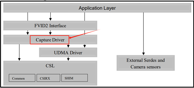

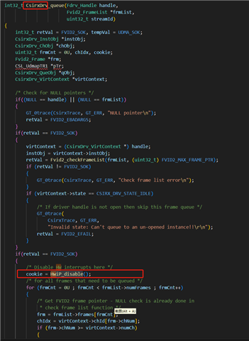

    I want to obtain the frame rate at the driver level, with the software architecture as shown in the diagram below. Whenever MIPI outputs a frame to the platform, the platform driver should be able to capture the frame rate.
    The same timestamp mentioned above is also available in the driver as well, which you could use to calculate the FPS
    Please check the variable "timeStamp = gCsirxCommonObj.getTimeStamp(NULL);" in  CsirxDrv_udmaCQEventCb() in PDK/packages/ti/drv/csirx/src/csirx_drvUdma.c
