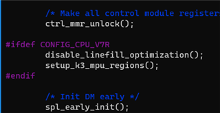

  • Hi, Keerthy
       Actually, we want to use MCU_MCSPI0 immediately after spl_early_init() in arch/arm/mach-k3/j721e_init.c , is this possible?Where can I use MCU_SPI0 first?
    Yes. Please try reading from there and check. After spl_early_init add prints.
    - Keerthy
  • Hi, Keerthy
    It seems like the console is not ready right after spl_early_init. After adding prints there is no output from the serial port
  • Do you have a debugger? You can attach and read register values.

    @@ -218,7 +218,17 @@ void board_init_f(ulong dummy)
    /* Init DM early */
    spl_early_init();
    + u32 debug;
    + debug = readl(0x40300000);
    + printf("\n");
    + ret = uclass_find_device_by_seq(UCLASS_SPI, 2, true, &dev);
    + if (ret)
    + panic("failed to find spi2!\n");
    + /*struct udevice *bus;
    + ret = uclass_get_device_by_seq(UCLASS_SPI, 2, &bus);
    + if (ret)
    + panic("failed to get spi2!\n");
    #ifdef CONFIG_K3_LOAD_SYSFW

    I read the register after spl_early_init() and print it after preloader_console_init(),the serial port output is as follows
    But once I add uclass_get_device_by_seq after uclass_find_device_by_seq,spl will get stuck and there will no output from serial port
  • I believe you will need to add register write sequences to directly program the module. Are you trying to get the spi driver probe?
    Keerthy
