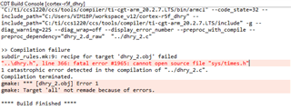

My goal is to run Dhrystone benchmark on one of the R5F MCU cores of the SoC.
Based on the resource I1ve found: software-dl.ti.com/.../Foundational_Components_IPC_J721E.html
I need a .xer5f file containing the firmware. But not very much information on how to create one.
Also managed to found among the forum posts that Code Composer Studio might be capable of producing such file for AM33X SoCs.
My question is: Can xer5f files created by CCS be used for the j721-evm 5F MCU (DM) firmware binary?
Thanks a lot!
