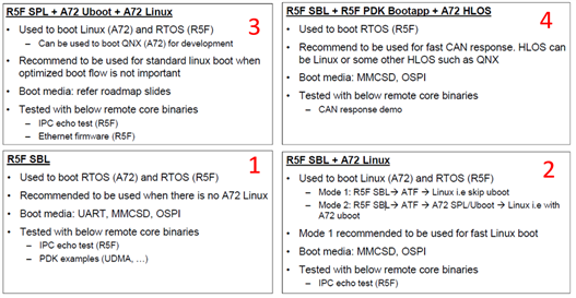

    In addition, i found the following image from TI which provides some booting options (i drawed some red number to each square for better reference to  each option in the image):
    Where if i understand correctly:
    Question 1: The option 1 is achievable only using SDK-RTOS, option 2 is achievable using SDK-RTOS + SDK-LINUX, option 3 also requires SDK-RTOS + SDK-LINUX, and finally option 4 requires of SDK-RTOS + SDK-QNX, could you please confirm if this is right? (i d appreciate if you correct me if is not)
    My "plan" is to follow this below sequence (the final expected goal is to run LinuxKernel in MAIN_A72 and that is why i think SDK-RTOS+SDK-LINUX is enough avoiding SDK-QNX):
    MCU_ROM -> R5F SBL -> ClassicAutosarAppImg -> A72 SPL -> A72 UBOOT -> LinuxKernel
    Question 2: This sequence seems to match with the number 3 from the image, i also thought about number 2 (which is the same but removing U-BOOT) but seems to require more complexity (additional configurations to be done) to be achieved due to UBOOT removal, am i right?
    Question 3: The only point i have not been able to figure out yet even reading a lot is how i could make ClassicAutosarAppImg to launch A72 SPL, any idea? (seems like the ECUM / BSWM could do the job...)
    Question 4: Could you suggest me which option is the most recommended for my "plan" so i can choose the indicated one (even if is not in the image)?
    I hope these questions are more clear now and sorry for the previous confusion i created with messy concepts/SDKs.

  • Hi Jaime,
    I read the SDK LINUX and RTOS documentation and now i have a more clear understanding of the whole sequence.
    Yeah, most of your understanding is correct.
    This looks to be a slightly older slide. Anyway, A72 RTOS is no longer supported, so Option #1 is just reduced to R5F and C7x cores.
    The RTOS SDK is not required for booting (R5 SPL is part of U-Boot in Linux SDK) Linux in Option #3, but RTOS SDK is needed to build the full-fledged Vision related firmware images.
    Option #4 requires RTOS SDK + either Linux SDK or QNX SDK (and not both), depending on which is your desired HLOS.
    Your plan looks ok. Where do you plan to boot the MAIN R5F and C7x cores, since they can be booted from either A72 U-Boot or Linux Kernel or your MCU1_0 Application firmware?
    This is actually Option #4. Option 3 does not use the RTOS SBL, it uses the Linux U-Boot SPL.
    Correct. This is a variation of Option #4. Option #2, Mode-1 is the R5 SBL directly booting Linux (followed by MCU R5F application), and requires you to have the final DTB and either change ATF to jump to the kernel load address, or change the address at which the Linux Image has to be loaded to match the address used by ATF.
    You are really looking at Option #4 or variants of it depending on whether you want to go through U-Boot or not for loading the kernel Image.
    MCU_ROM -> R5F SBL -> ClassicAutosarAppImg is essentially Option #4 and, the ClassicAutosarAppImg is equivalent of the PDK BootApp from this option.
    In the end, what really matters is your product goals, and whether you need A72 SPL/U-Boot or not, and from where you want to load the other R5F and C7x firmware images.

  • Great! now everything starts to get clear to me, i had decent understanding in RTOS-SDK reading the documentation but now i am learning about LINUX-SDK (mainly HLOS) and how to use them (RTOS-SDK and LINUX -SDK) together for my final plan to develop.
    I will follow the Option #4 from the image shared in previous comment, obtaining the following sequence as the final one (i dont plan to use QNX but only RTOS-SDK + LINUX-SDK to be capable to trigger A72):
    MCU_ROM -> R5F SBL -> ClassicAutosarAppImg -> ATF -> A72 SPL -> A72 UBOOT -> LinuxKernel
