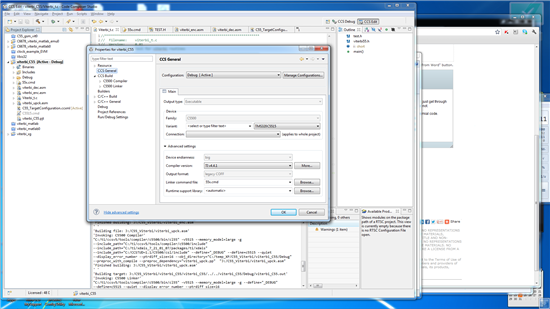

    I am glad to know your progress. I am not familiar with C55x. At first, I set to chip "Generic C55xx Device" in CCS v5.1, there are some building warnings. I just get through this by setting to TMS320C5515 (Is it right?). The building has passed through, but the result "dec_out" is not the same with "frame", no matter reverse or not.
    Do your modification of T3, and/or other corrections, are necessary? If yes, could you send me the code with modification? I do not ask for the new polynomial code.
    The endiann is default as "big endianness". Is this right? This is quite different from C6000.
    I submit the project settings here. Please check it for me.
    Thanks.

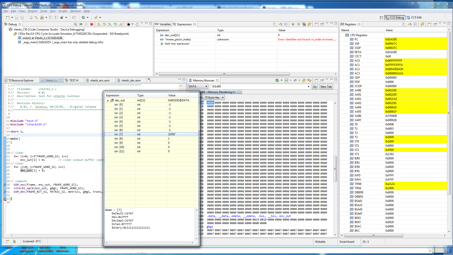

    I don't think the original program is right. I create a simple case, only one bit set while the rest are 0s (It is in the attached test.h file). The output signal (dec_out) should return to 0s. From the picture we can see that it is not return to 0 (On the contrary, there are many 1's thereafter). There may be some problem still exist, at least in this rare, simple case. Thanks.

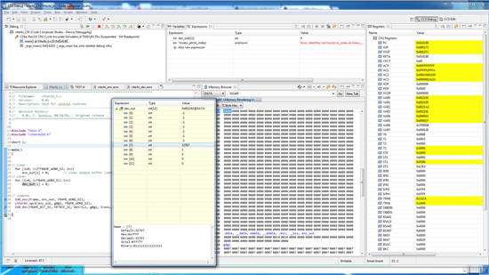

  • I try input info bit stream: 00000000000000110000000000.. The dec_out does not pass. It has the similar problem as the 000000000000100000000000.....case.
    The more strange result from all 0s input. The dec_out cannot be recognized by debugger. I shall look into it if I have time.
